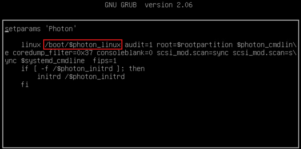

This issue occurs when the /boot/grub2/grub.cfg file is modified on the VMware vCenter Server Appliance and the value '/boot' is added before the /$photon_linux variable.

  2. After the VCSA Photon OS starts, press the e key to enter the GNU GRUB Edit Menu.
  3. Locate the line that begins with the word "linux".
  4. Remove this value from the beginning of the line -
    /boot
    The line should look similar to the following screenshot:
  5. Press the F10 key to continue booting.

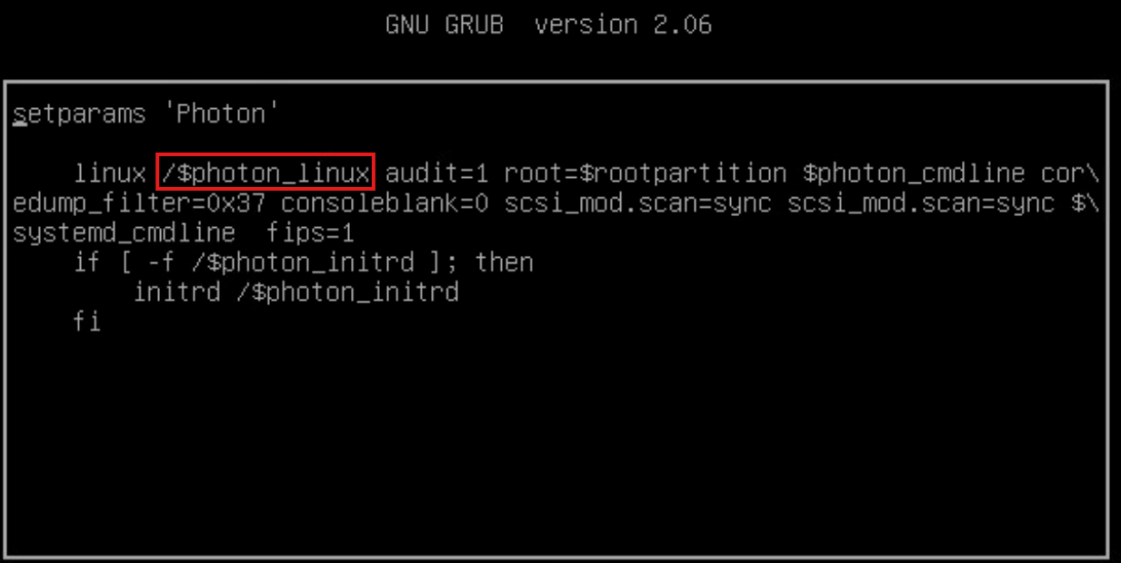

  8. Using the arrow keys, scroll down until you find the menuentry section.
  9. Modify the entry to remove the /boot after the word linux
