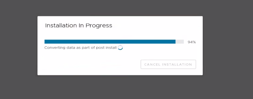

  • Additionally, the vCenter Server Appliance Management Interface (VAMI - port 5480) is stuck showing an ongoing installation: Installation In Progress 94% - Converting data as part of post install

  • The vCenter appliance update state configuration file becomes desynchronized from the actual patching process.
  • Even though the patching process has completed successfully (confirmed by Patch vCSA succeeded in the /var/log/vmware/applmgmt/PatchRunner.log), the appliance's software update state file (/etc/applmgmt/appliance/software_update_state.conf) fails to clear and remains incorrectly flagged as INSTALL_IN_PROGRESS. Because the system believes an installation is actively running, it blocks access to vLCM features in the vSphere Client.

  1. Log in to the vCenter Server Appliance via SSH as the root user.
  2. Create a backup of the current software update state file:
    cp /etc/applmgmt/appliance/software_update_state.conf /var/core/software_update_state.conf.bak
  3. Stop the appliance management service: service-control --stop applmgmt (Note: You may see a message stating "Operation not cancellable. Please wait for it to finish...". Allow it to complete until you see "Successfully stopped service applmgmt".)
  4. Remove the stuck state configuration file (Press y to confirm removal when prompted):
    rm -i /etc/applmgmt/appliance/software_update_state.conf
  5. Start the appliance management service back up: service-control --start applmgmt
  6. Log out of the vSphere Client and VAMI, then log back in. The VAMI will no longer report a stuck installation, and the Image tab will be restored.
