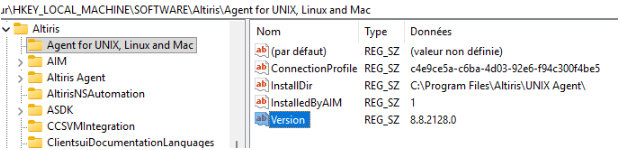

  1. On the ITMS server, open the registry key:
       HKEY_LOCAL_MACHINE\SOFTWARE\Altiris\Agent for UNIX, Linux and Mac\
  2. Change the version value from 8.8.2126 to 8.8.2128 so it matches the actual agent package version being pushed.

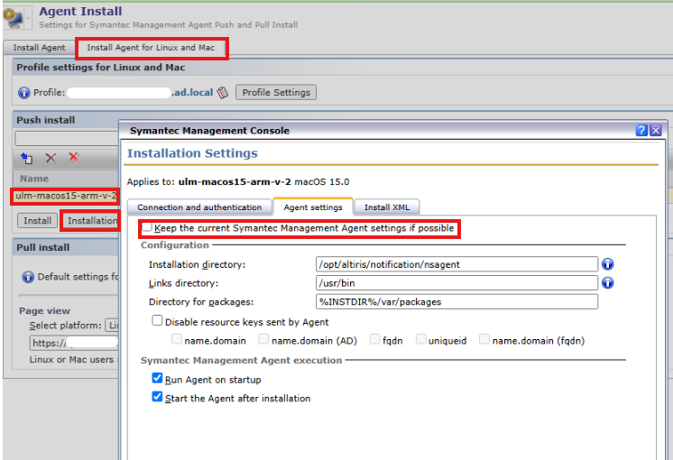

  3. On the ITMS console, go to: Settings > Agents/Plug-ins > Symantec Management Agent > Settings > Agent Install > Install Agent for Linux and Mac tab.
  4. Select the affected Mac machines, open the "installation settings", and confirm Keep the current Symantec Management Agent settings if possible is unchecked.
  5. Run the push install.
  6. Confirm the affected machines complete a full reinstall (not an upgrade) and that the agent starts and registers with the SMP Server.
