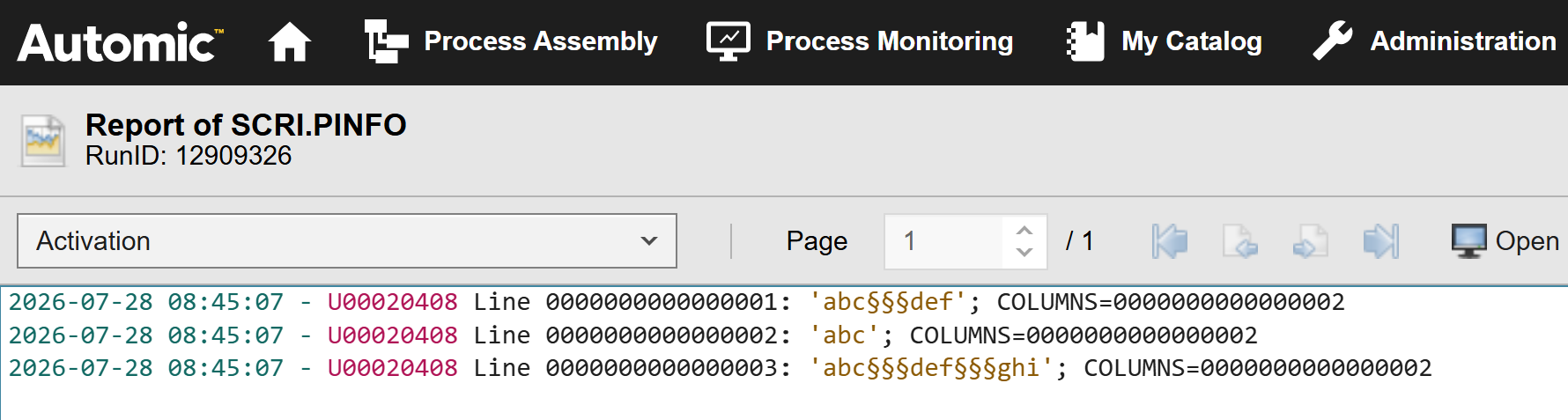

We observed unexpected behavior when using GET_PROCESS_INFO with the COLUMNS parameter inside a process loop.
According to the documentation, GET_PROCESS_INFO(Process, COLUMNS) returns the number of columns in the current line of the specified data sequence if it used with in a process loop.
However, when a process contains lines with different numbers of columns, GET_PROCESS_INFO(&HND#, COLUMNS) does not appear to evaluate the current line. Instead, it returns the column count of the first line for all subsequent lines.
The following simplified script reproduces the behavior:
:SET &HND# = CREATE_PROCESS(NEW):SET &RESULT# = PUT_PROCESS_LINE(&HND#, "abc,def", ","):SET &RESULT# = PUT_PROCESS_LINE(&HND#, "abc", ","):SET &RESULT# = PUT_PROCESS_LINE(&HND#, "abc,def,ghi", ","):PROCESS &HND#: SET &LINE# = GET_PROCESS_LINE(&HND#): SET &INDEX# = GET_PROCESS_INFO(&HND#, INDEX): SET &COLUMNS# = GET_PROCESS_INFO(&HND#, COLUMNS, &INDEX#): PRINT "Line &INDEX#: '&LINE#'; COLUMNS=&COLUMNS#":ENDPROCESS:CLOSE_PROCESS &HND#
The report shows column count as 2 for all the lines whereas the process contains different column count
24.4.X, 26.X
Product working as expected and the documentation needs to be updated.
The documentation will be updated as follows:COLUMNS: Retrieves the number of columns the defined Line has. Use this key with the Line parameter to define the number of the Line that should be used for that purpose. If you do not specify Line, the first Line is retrieved.
