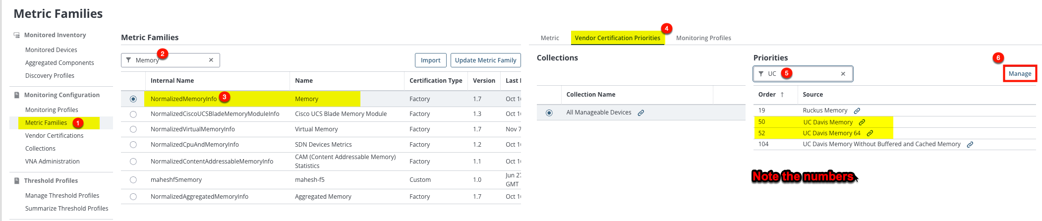

Check to see if the device supports the UC Davis 64bit Memory counters (See Additional Information Section).

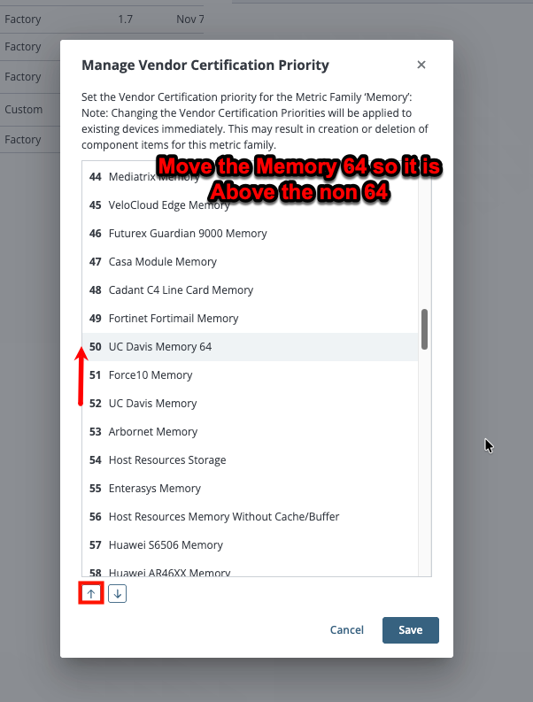

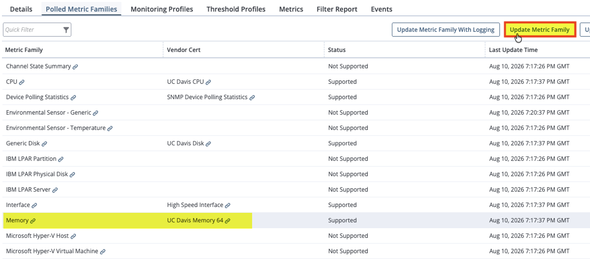

you must instruct the Data Aggregator to use 64-bit OIDs (which support larger memory values) by adjusting the Vendor Certification priority.
If the issue persists after these steps, please contact your Support Engineer (SE) to verify if additional metric family adjustments or custom OID configurations are required for your specific device model.
