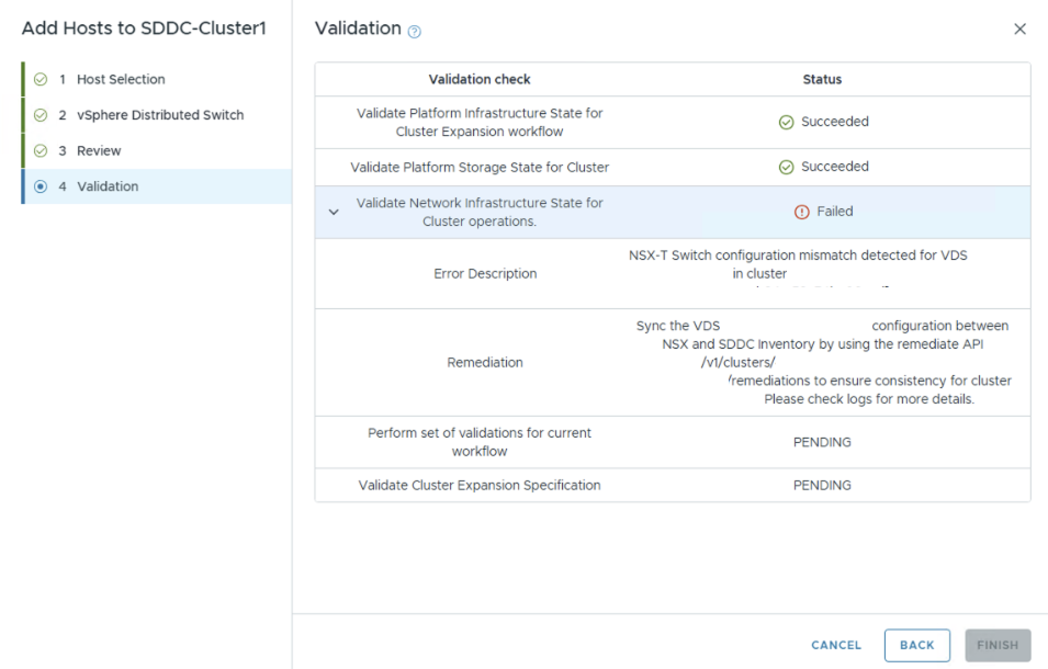

  • Add ESX host to cluster failed at validation after commissioning it into SDDC inventory.
  • The error message is like below.

SDDC Manager 9.1
As part of the OOB(Out Of Box) feature introduced in 9.1, we detect configuration drift between SDDC Manager inventory and NSX-T.
Currently, the VDS object in the SDDC inventory does not include the NSX-T switch configuration, even though it should be present when a Transport Node Profile (TNP) is configured on the cluster from NSX.
Since the inventory value is null, the system detects this as a drift and prompts the user to run the remediation API.
Follow the steps mentioned in the Validation table(Remediation) and execute the remediate API to synchronize the inventory.
This will align the SDDC Manager inventory with NSX-T and help avoid inconsistent inventory issues going forward.
