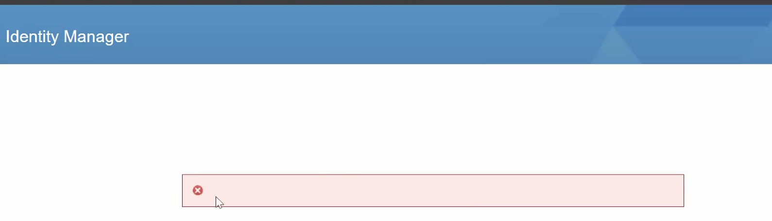

  • The VMware Identity Manager UI is inaccessible and displays a red box error when accessed via VIP FQDN
  • Access issues persist even after releasing Liquibase database locks and verifying directory permissions.
