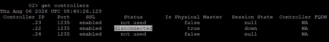

  • The ESXi transport node reports an NSX controller status of "disconnected" in the NSX UI or via nsxcli -c get controllers.
  • Physical network connectivity (ports 1234 and 1235) between the ESXi host and the NSX Manager/Controller is confirmed healthy via nc tests.
  • The nsx-nestdb service on the ESXi host is active
  • Central Control Plane (CCP) logs on the NSX Manager report COMMUNICATION_ERROR or session timeouts specifically during the VersionMastershipHandshake process for the affected transport node
  • NSX manager .22 node id is 647#####-####-####-####-ff#####df53 and NSX manager .24 node id is 6ce9eb3d-####-####-####-9851be54b365
  • As per the ESXi host get controllers output, the controller master is NSX manager .22 with id 647#####-####-####-####-ff#####df53. However, nsx-ccp.log file reports controller is other node 6ce9eb3d-####-####-####-9851be54b365

The NSX Manager Central Control Plane (CCP) service experiences a logical hang or internal session mismatch for specific transport nodes. This prevents the VersionMastershipHandshake from successfully initializing, causing the NSX Manager to reject the connection attempt from the host despite valid certificates and network reachability.
  1. Identify the NSX Manager node currently acting as the master from the nsx-ccp.log file.
  2. Reboot the problematic NSX Manager node to clear the hung CCP service state.
  3. Once the manager node returns to an "UP" status, allow time for the CCP services to re-initialize and re-establish sessions with the ESXi transport nodes.
  4. Verify the controller connectivity status on the ESXi host by running the following command: nsxcli -c get controllers
  5. If the status transitions to "up" or "connected," the issue is resolved.
