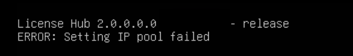

After the License Hub 2.0 appliance is deployed and powered on, the appliance starts but the setup does not complete. The following error is displayed:
Symptoms
  • The OVA/OVF deployment itself completes without error.
  • The appliance reports the failure at the IP pool configuration stage after first boot, on the virtual console.
  • The appliance management IP does not respond to ping.
  • The License Hub UI is not reachable, or reports that services have not started.

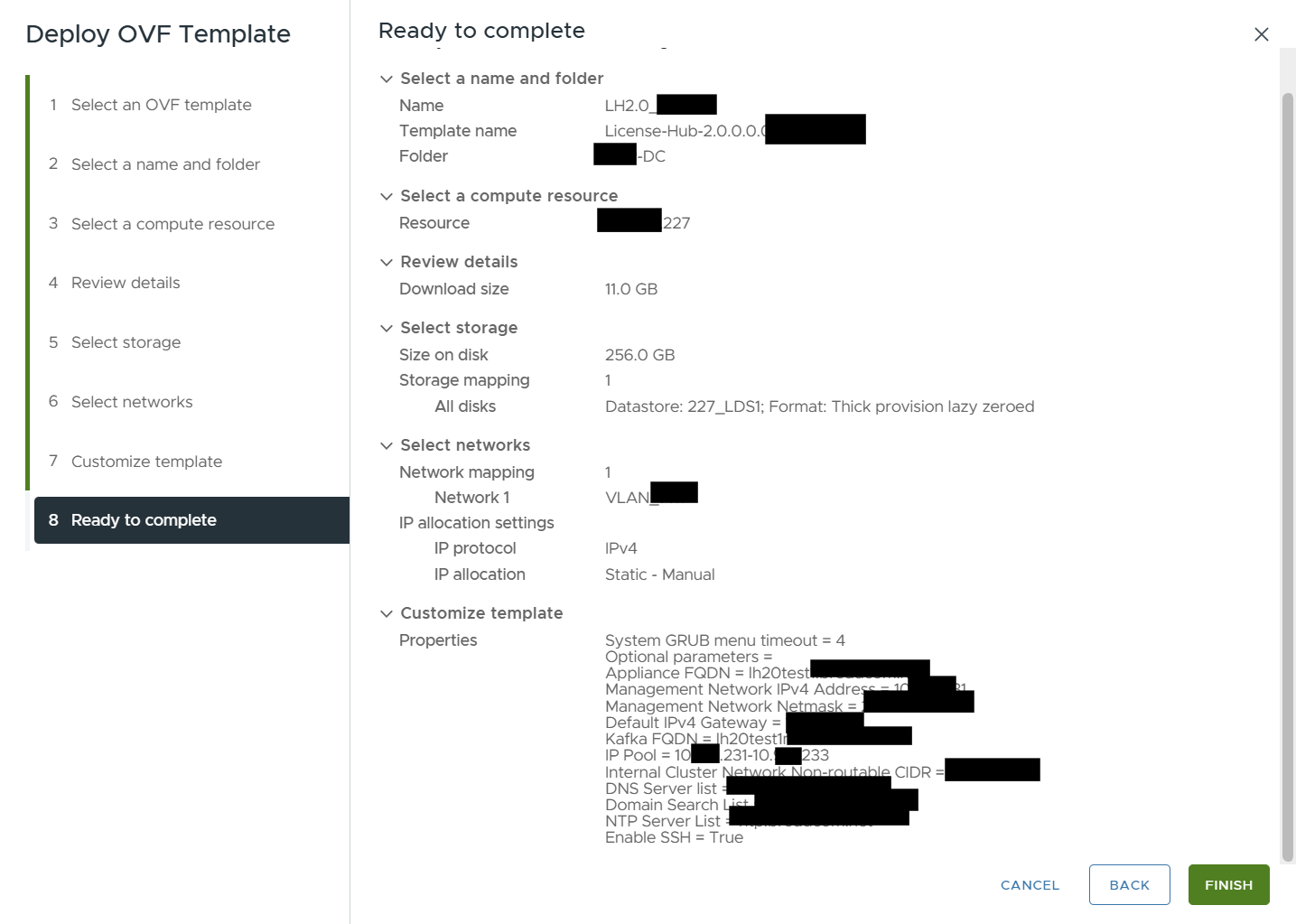

Example of a failing configuration
The Ready to complete page below shows both problems at once — the pool contains three addresses, and the appliance management IP is the first address in that pool:
Property
Value
Management Network IPv4 Address
10.#.#.231
IP Pool
10.#.#.231 – 10.#.#.233
License Hub 2.0 requires three IP addresses in total: one for the appliance, and two for the IP pool.
#AddressRequirement
1Appliance management IPMust have a fully resolvable FQDN (forward and reverse). Must be outside the IP pool range.
2IP pool — first addressMust be the address immediately below the Kafka node IP (the pool is two consecutive addresses).
3IP pool — second addressMust be the Kafka node IP, with a fully resolvable FQDN (forward and reverse).
Corrected example
Using the same addresses as the failing deployment above:
Role
Value
Appliance FQDN
lh20test.example.com
10.#.#.231
Kafka FQDN
lh20test1kafka.example.com
IP Pool
10.#.#.232 – 10.#.#.233
Kafka node IP (second address in pool)
10.#.#.233
