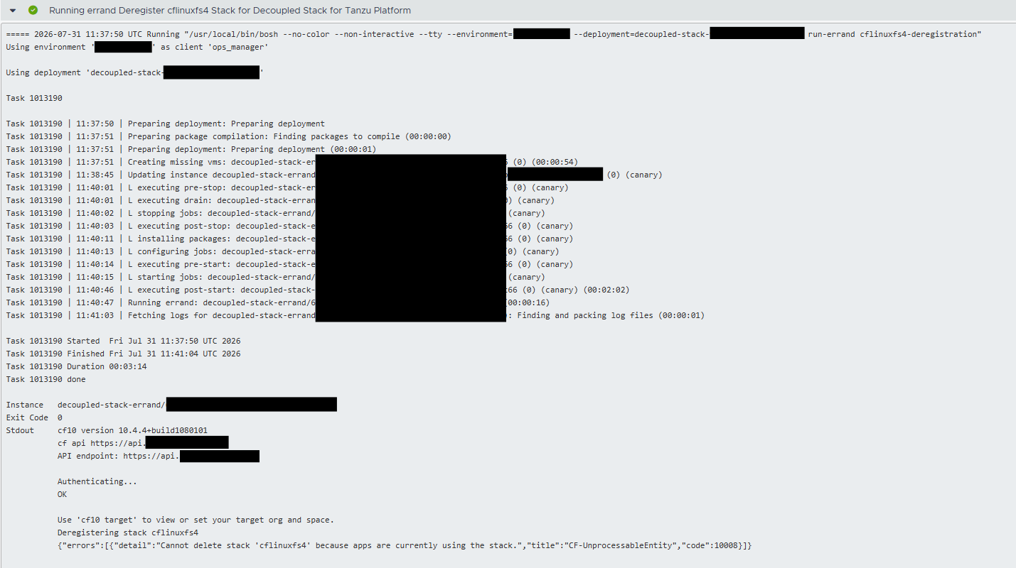

When uninstalling a Decoupled Stack tile from VMware Tanzu Application Service (TAS), the system may retain the updated cflinuxfs4 rootfs instead of reverting to the original version bundled with the TAS foundation. This results in the environment continuing to use the newer stack version despite the tile being uninstalled.
After upgrading a foundation with the Decoupled Stack tile and subsequently performing an uninstall, the Diego cells continue to report the updated cflinuxfs4 stack version (e.g., 1.344.0) instead of reverting to the foundation’s default version (e.g., 1.302.0).
The issue is primarily due to the rootfs remaining on the Diego cells; the uninstallation process does not automatically trigger a cleanup of these files from the cell storage.
The current architecture does not provide a native mechanism to run cleanup tasks for rootfs during the tile deletion process. Because the Diego cells do not automatically refresh the rootfs upon tile uninstallation, the cells continue to utilize the existing rootfs directory even after the runtime configuration is removed.
To restore the foundation to its previous cflinuxfs4 stack version, perform a BOSH recreate of the Diego Cells.
