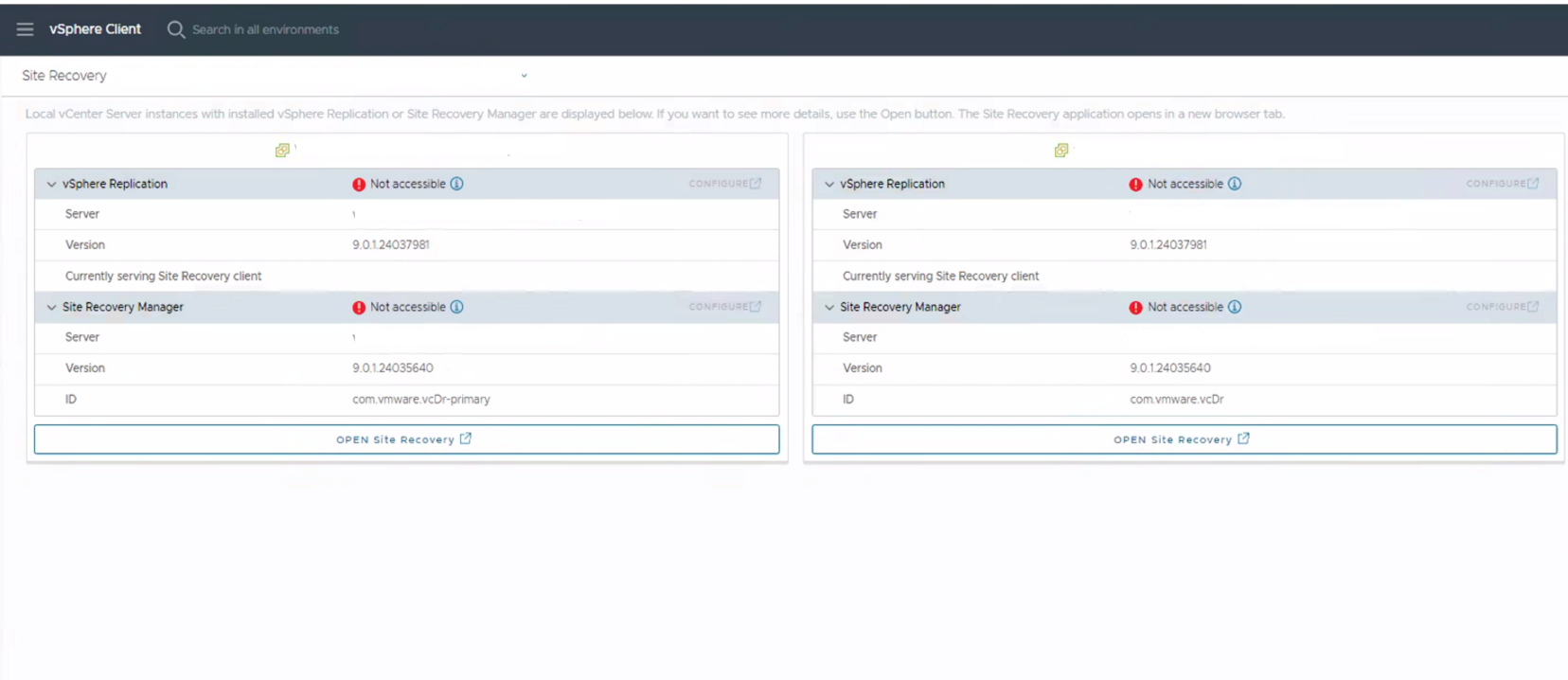

VMware Site Recovery Manager (SRM) and vSphere Replication (VR) plug-ins are currently displaying an 'Not-Accessible' state.
The following error is observed :

  • The vSphere Client fails to retrieve dynamic extension data from the plugin server. This indicates a communication failure where the requested endpoint returns a 404 Not Found status.
  • This behavior is typically caused by stale or misconfigured plugin registration within the vCenter Lookup Service, preventing the client from correctly resolving the plugin URL after the server restarts.
  1. Take a snapshot of the target vCenter Server Appliance before executing modifications.
  2. Unregister or remove the stale VR and SRM plugin extensions via the vCenter Managed Object Browser (MOB) (https://<vcenter-fqdn>/mob/?moid=ExtensionManager) Refer KB 337576
  3. Log into the vCenter Server Appliance shell via SSH as root.
    Query and validate active plugin registrations in the vCenter Lookup Service by executing:
    /usr/lib/vmware-lookupsvc/tools/lstool.py list --url http://localhost:7090/lookupservice/sdk --type VrUi
   4. Verify the output to confirm no stale, obsolete, or duplicate registration entries remain.
   5. Restart the vSphere Client user interface service to clear cached registration states:
        service-control --stop vsphere-ui && service-control --start vsphere-ui
   6. Log into the vSphere Client and verify that the SRM and VR plug-ins display an Accessible and Healthy state.
