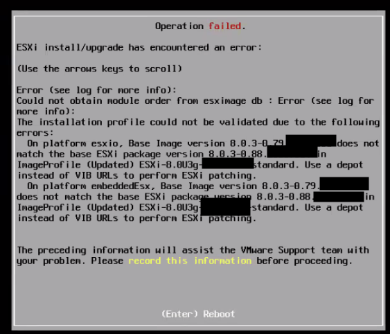

When attempting to apply an ESXi patch or update via console, the process fails with an error:
Could not obtain module order from esximage db : Error (see log for more info):
On platform esxio, Base Image version 8.0.3-0.79.<buildnumber> does not match the base ESXi package version 8.0.3-0.88.<buildnumber> in ImageProfile (Updated) <profile_name>. Use a depot instead of VIB URLs to perform ESXi patching.
similar to this example image:

The ESXi upgrade/patch operation fails because the target ISO/patch build number is lower than the build currently installed on the host.
VMware ESXi does not support downgrading the host version using a patch ISO, as this requires downgrading individual VIBs that are already in use.
