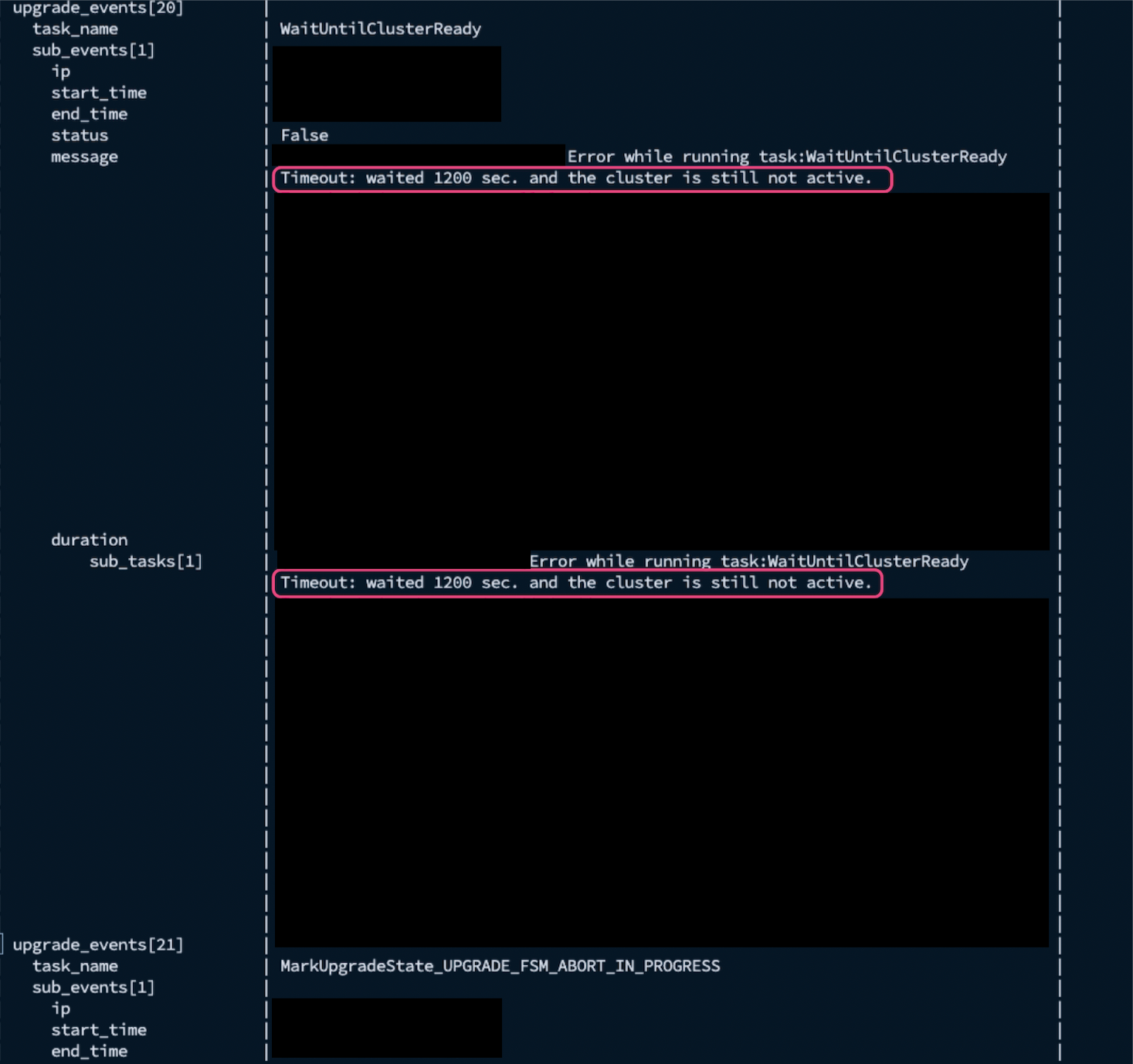

Upgrade to  31.2.1 and higher fails during the WaitUntilClusterReady task,with the following timeout error, indicating that the cluster is not active:
Timeout: waited 1200 sec. and the cluster is still not active.
Once the upgrade process has aborted, you can locate the timeout error by running the following command on the Controller CLI
shell
show upgrade status detail filter controller

  • The upgrade process times out (default 1200 seconds) during the WaitUntilClusterReady task.
  • The upgrade status is marked as UPGRADE_FSM_ABORT_IN_PROGRESS.
