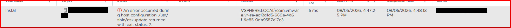

ESXi hosts in a vSphere cluster may intermittently or consistently report the error: "An error occurred during host configuration: /usr/sbin/esxupdate returned with exit status: 7."

Check vCenter Tasks: Observe recurring "Install" or "Host Configuration" tasks failing with the exit status: 7 error in the vCenter Server Task pane.
