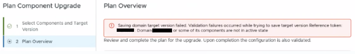

While running the upgrade planning for VMware Cloud Foundation (VCF) components, such as updating a workload domain's vCenter via VCF Operations, the validation process fails to save the target version.
  • The UI displays a validation error: Saving domain target version failed. Validation failures occurred while trying to save target version Reference token: QT###8: Domain example.com or some of its components are not in active state
