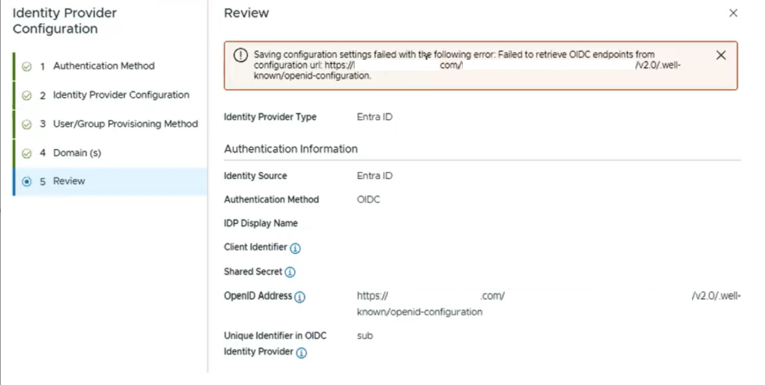

If you encounter the error: Saving configuration settings failed with the following error: Failed to retrieve OIDC endpoints from configuration url , when configuring the Entra ID in VCF Operations, verify the tlsEnabled parameter in your API payload. If your proxy server does not accept TLS connections, ensure "tlsEnabled" is set to false. Setting this to true when the proxy does not support it will cause the configuration to fail.
