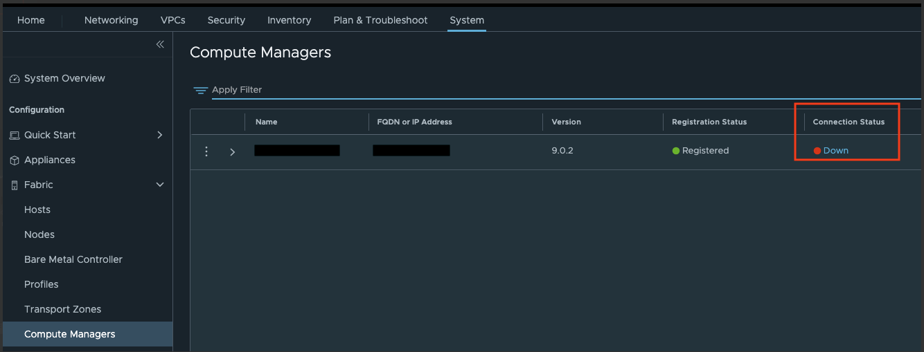

After a vCenter root certificate is replaced , the connection between NSX and vCenter might break and cause the NSX Compute Manager Connection Status to be Down on the System > Fabric > Compute Managers NSX UI. Clicking Down displays the following error message:

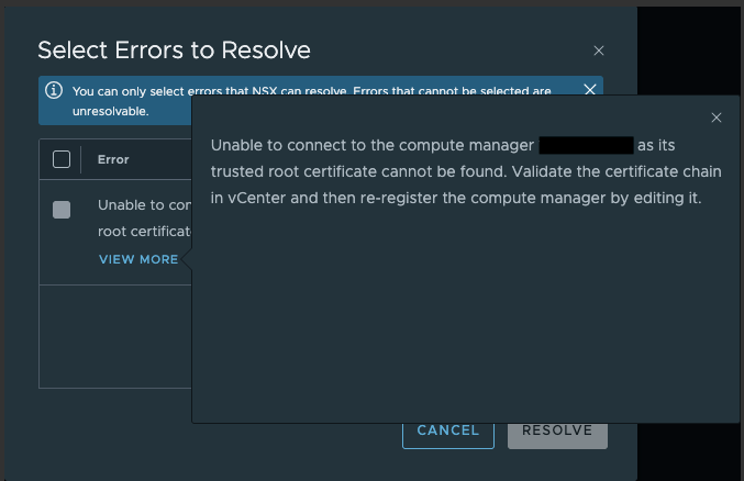

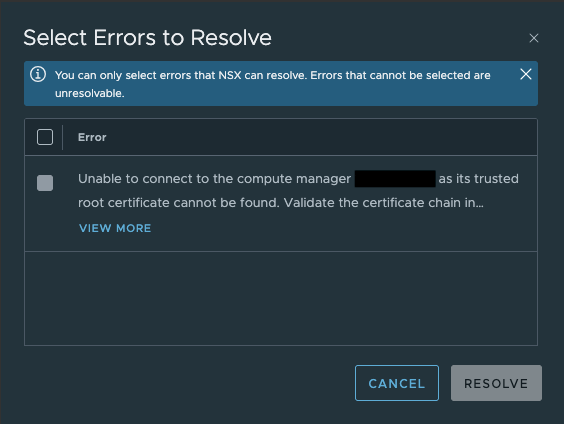

Unable to connect to the compute manager <Compute Manager Host Name> as its trusted root certificate cannot be found. Validate the certificate chain in vCenter and then re-register the compute manager by editing it

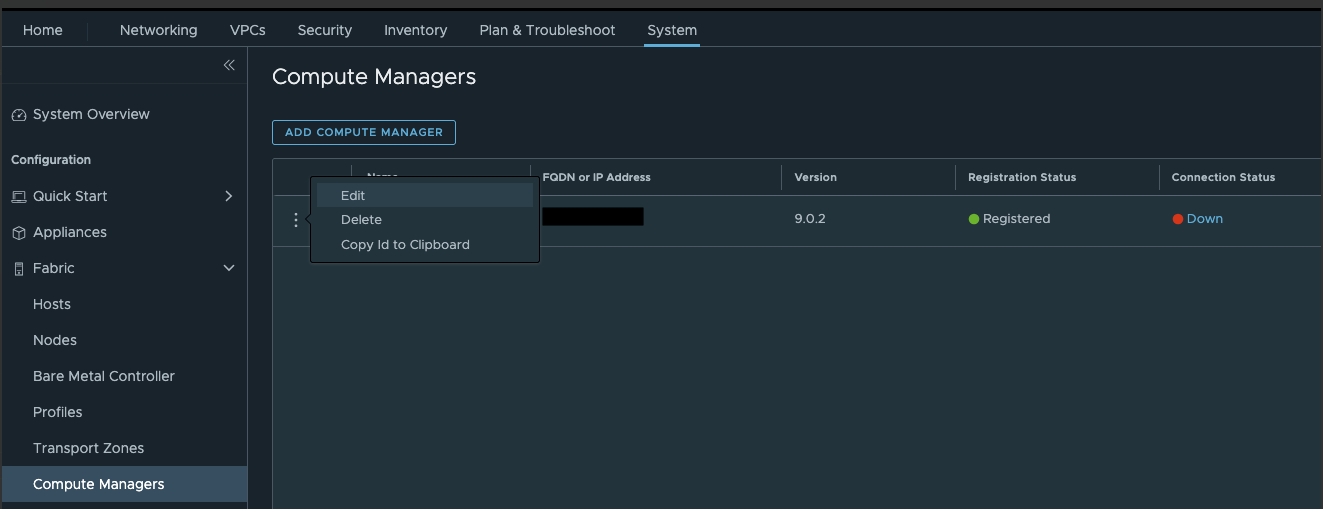

Step 2: Navigate to System > Fabric > Compute Managers.

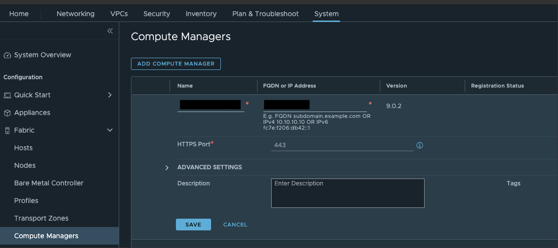

Step 3: Select the affected Compute Manager and click Edit.

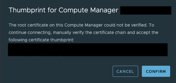

Step 4: Click SAVE without making any changes. NSX detects the new certificate thumbprint and prompts you to confirm it.
Step 5: Click CONFIRM to accept the new thumbprint, import valid root certificate and complete re-registration.
Step 6: Verify that the Connection Status shows Up.
