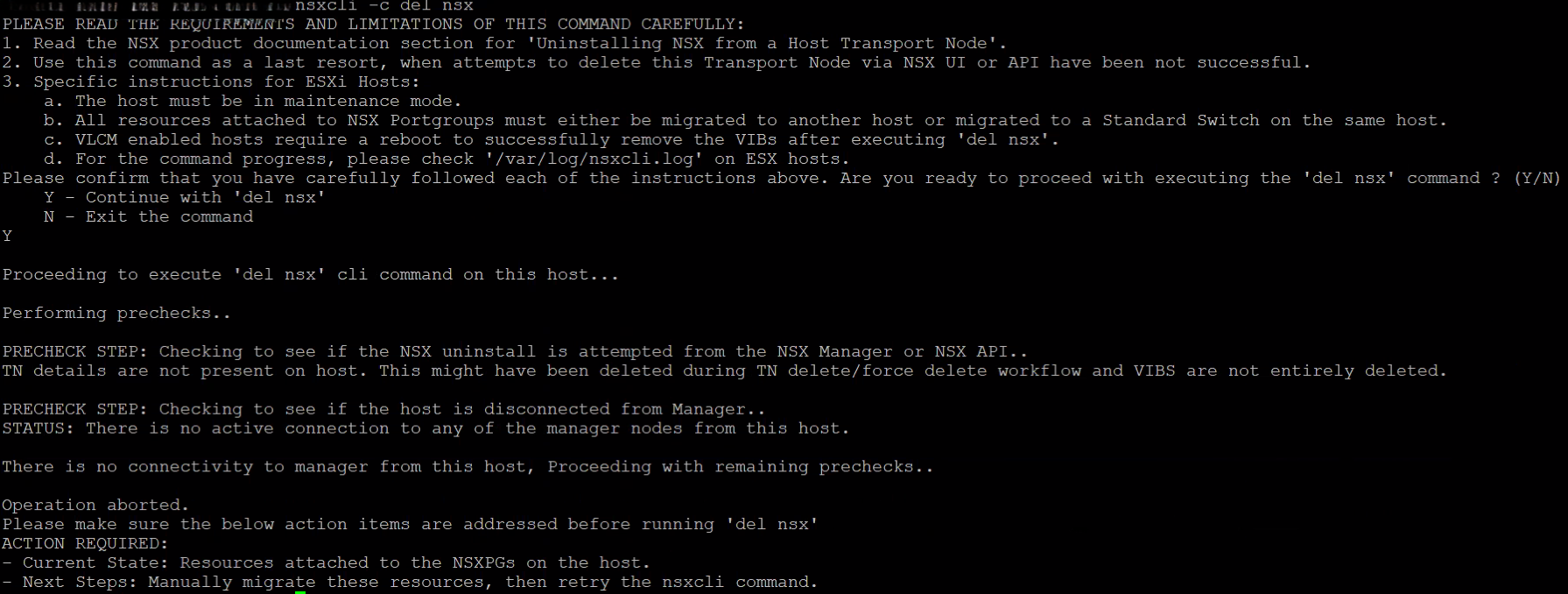

  • When attempting to remove NSX VIBs from an ESXi host via the CLI, the process fails due to active network resource attachments.
  • Executing the VIB removal task returns the following explicit error message:
    • Current state: Resources attached to the NSXPGs on the host, manually migrate and then try again. Next Step: Manually migrate these resources then retry the NSXCLI command.
  • Stale virtual machine inventory records remain registered (visible in nsxcli.log) on the host even if workloads were previously migrated.

  • Stale VM object entries and port references remain cached within the ESXi and the vDS in database. Although the virtual machines have been migrated to alternate hosts, these orphaned object references maintain active resource locks on the NSX Port Groups (NSXPGs).
To resolve this issue, the local DVS database must be re-initialized and the host rebooted to clear the stale runtime states.
