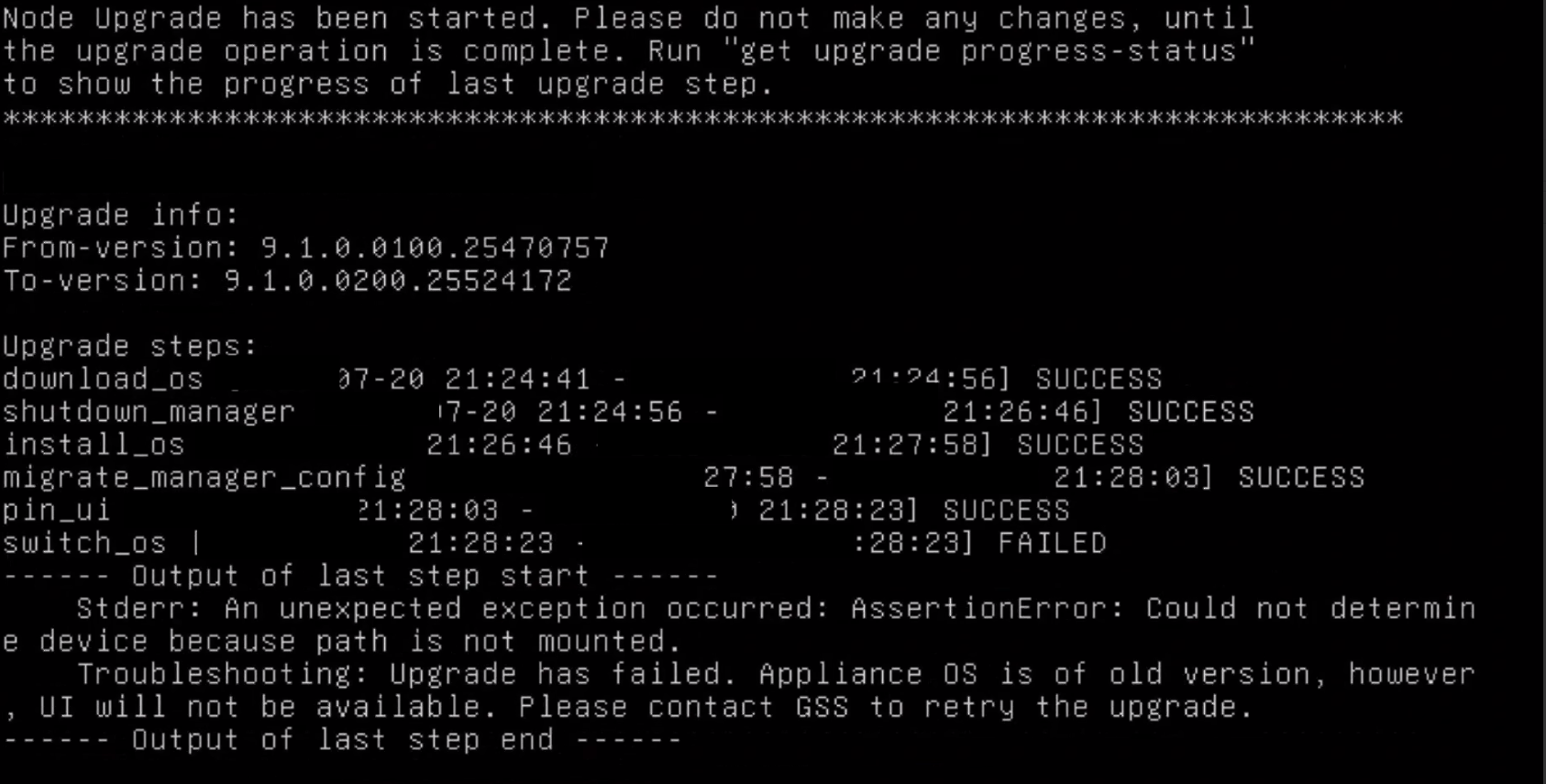

  3. The upgrade stalled at the switch_os step due to a mount path assertion error (AssertionError: Could not determine device because path is not mounted).

  6. get upgrade progress-status shows:
  • VMware Cloud Foundation 9.1.x
  • VMware NSX 9.1.x
This issue occurs due to a failure in the automated upgrade playbook execution on the individual manager node.
