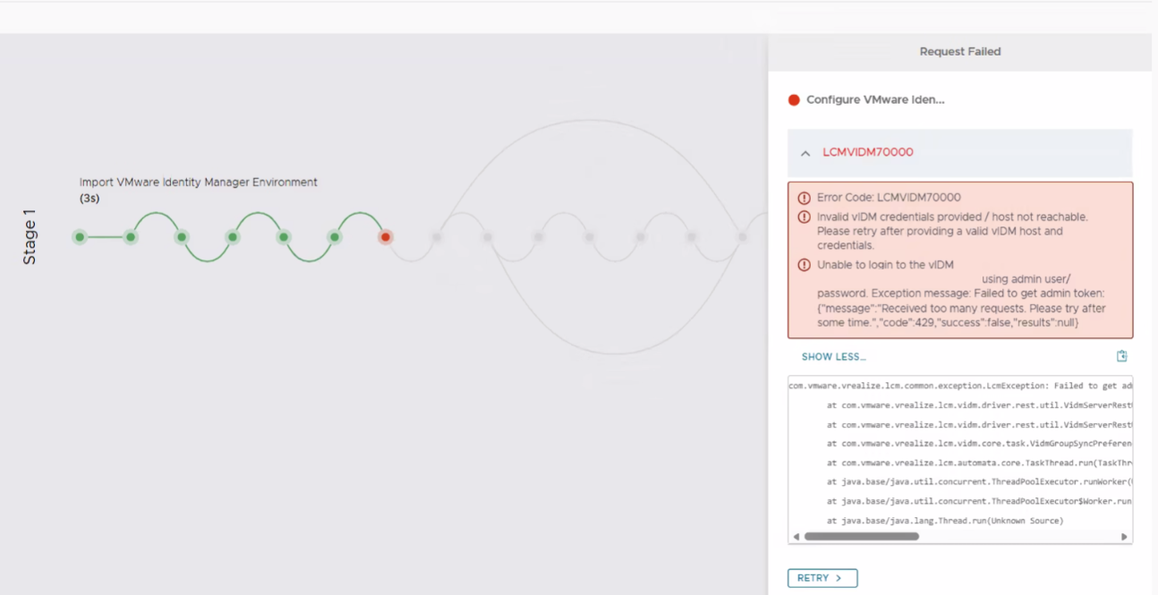

Performing an Inventory Synchronization for VMware Identity Manager (vIDM) in VMware Aria Suite Lifecycle Manager fails on initial execution.
The following error is displayed in the Aria Suite Lifecycle UI:
Error Code:LCMVIDM70000
Invalid vIDM credentials provided / host not reachable.
Please retry after providing a valid vIDM host and credentials.
Unable to login to the vIDM <vIDM-FQDN> using the admin user/password. Exception message: Failed to get admin token: {"message":"Received too many requests. Please try after some time.","code":429,"success":false,"results":null}
Reviewing /var/log/vrlcm/vmware_vrlcm.log reveals the following REST API error:
ERROR [VidmPromoteDefaultConfigurationUserTask] -- Failed to login to vIDM vIDMServer{host=<vIDM-FQDN>, tenant=null}. com.vmware.vrealize.lcm.common.exception.LcmException: Failed to get admin token: {"message":"Received too many requests. Please try after some time.","code":429,"success":false,"results":null}
