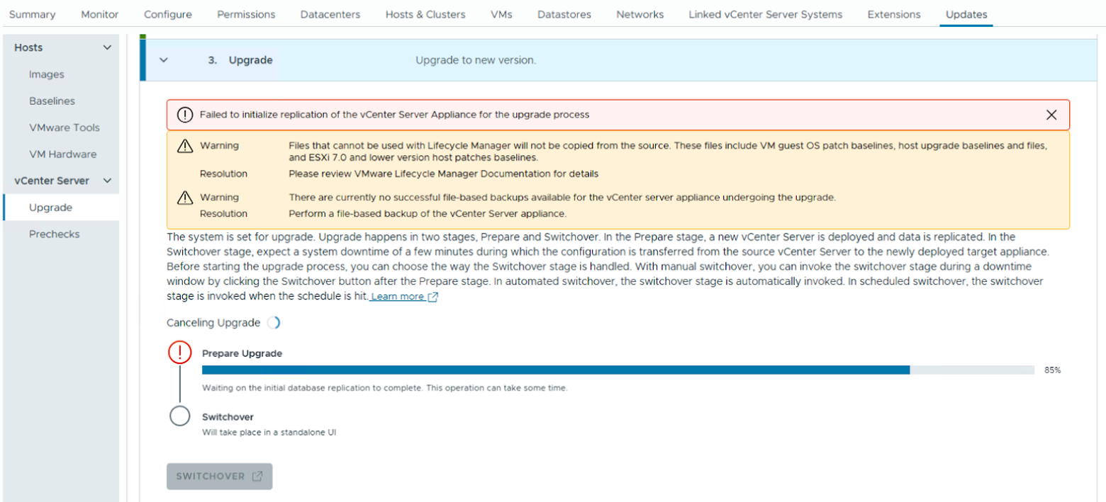

vCenter RDU/NDU Upgrade fails with the following error:
Failed to initialize replication of the vCenter Server Appliance for the upgrade process
