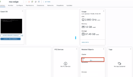

VMware NSX Edge node is displaying incorrect host location information within the NSX UI. Visual verification confirms that the NSX Edge virtual machine is running on a different ESXi host than the host currently reported by the NSX Manager. No host mismatch alarm or alert has been triggered within the NSX environment.
Note: These screenshots indicate that the NSX Edge is located on a different host than what NSX is reporting
