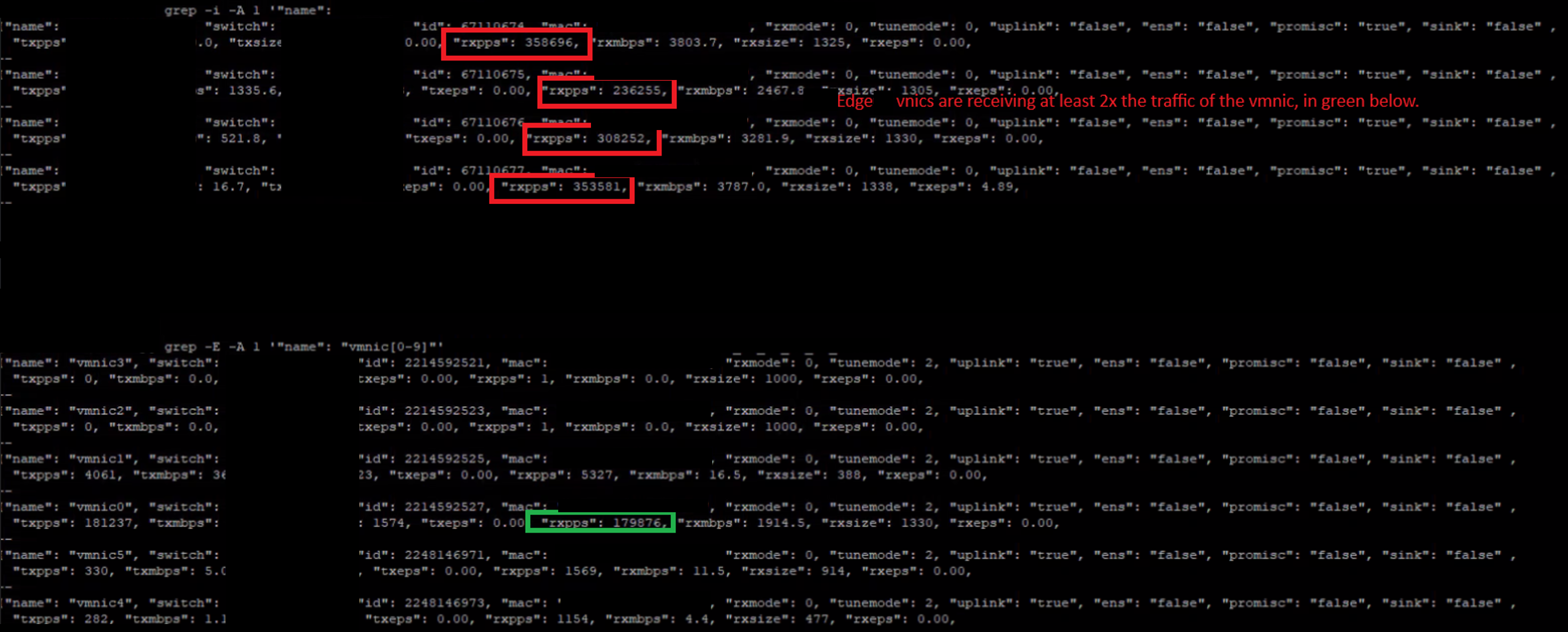

Additionally, you may observe that Edge virtual network interfaces (vNICs) receive two or more times the amount of traffic compared to your physical vmnics as observed from net-stats, causing the CPU assigned to be consistently overutilized.
