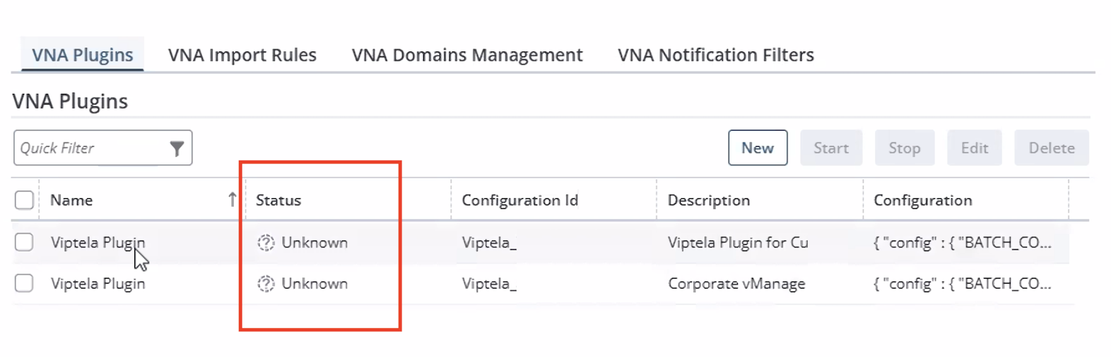

Plugin shows an Unknown Status in Portal:
