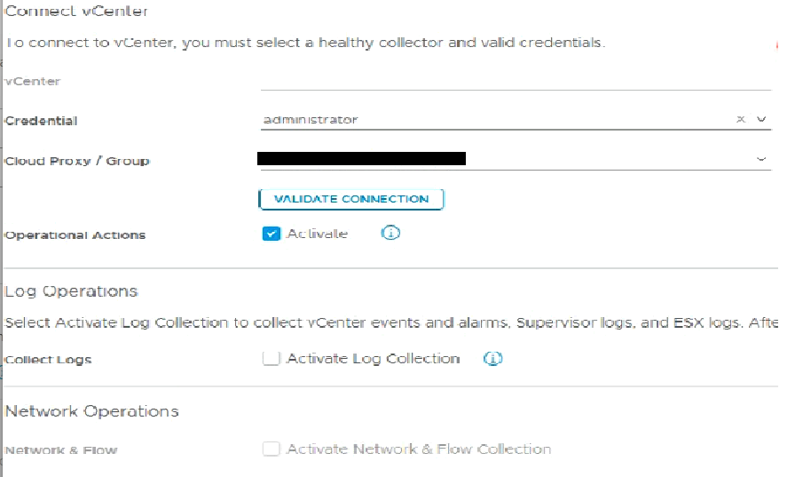

  • You add the vCenter data source and it gets added successfully but within 2-3 minutes the vCenter instance name is missing and NetFlow is disabled
