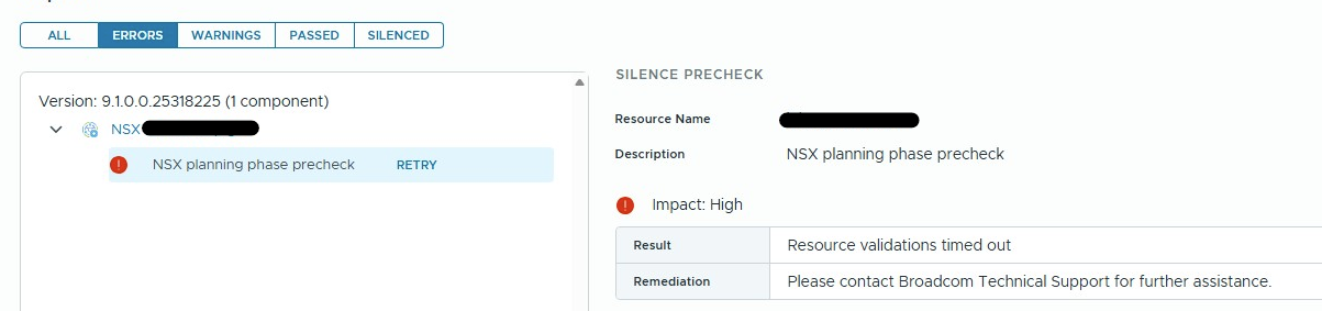

  • VMware Cloud Foundation (VCF) upgrade precheck fails for NSX during the planning phase. Retrying the upgrade precheck results in a failure at the same stage with the following error: "NSX planning phase precheck fails"

The issue is caused by a credential mismatch between the SDDC Manager database and the NSX Manager appliance.
The audit account is disconnected in SDDC Password Management, resulting in a 403 Forbidden error when fetching OIDC endpoint information.
The SDDC platform database reflects a stalled audit state ("Failed to load NSX Cluster from the Inventory"), which prevents the precheck from successfully validating NSX resources.
