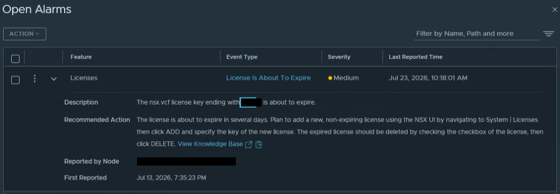

Alarm for "License Is About To Expire" in NSX Manager in VCF 9.0 appears to be false positive
Article ID: 450262
VMware NSX
  • The alarm "License Is About To Expire" is triggered on at least 1 NSX Manager.
  • There is no indication the license is going to expire other than the alarm
VMware NSX
VCF 9.0
NSX 9.0 syncs license expiry with vCenter Server.  The license on the vCenter should be verified.
Workaround
  • Run the following command from the admin prompt on all 3 NSX Managers.
    start search resync all
  • Waiting at least one hour.
  • If the issue persists, and the vCenter license reports as expected, try rebooting the vCenter (Compute Manager) for the affected NSX Manager(s).
  • If this doesn't help, open a support case with Broadcom Support for further assistance.
