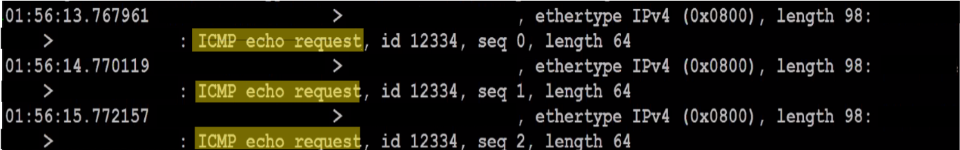

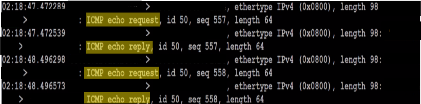

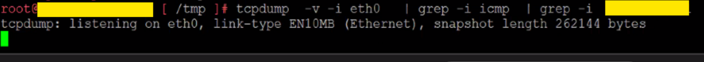

  • When ICMP ping is performed from vCenter to the ESXi host, the pktcap-uw packet captures show the ICMP reply is sent by the desitnation ESXi host management VMkernel adapter, and the specific ICMP reply is going out of the VMNIC physical NIC adapter where the host management is pointed to, however, the packets are not received on the VMNIC of the ESXi host where vCenter is.
From source vCenter's vmnic (physical nic adapter), the ICMP request packets are going out
On the destination ESXi host management vmnic (physical nic adapter), the ICMP requests are being received and corresponding ICMP responses are going out.
The ICMP responses are not seen on the vCenter vNIC
