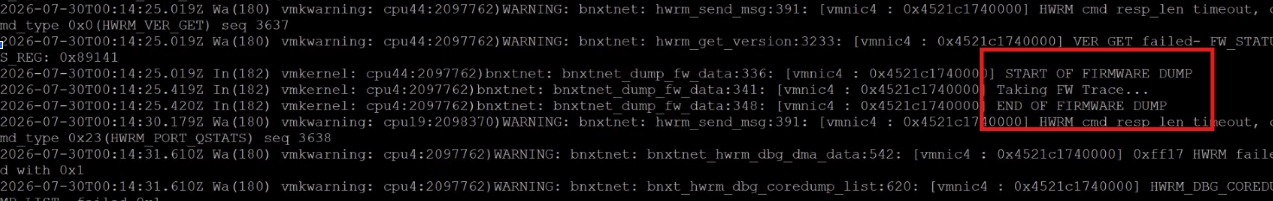

Log (vmkernel.log) analysis reveals firmware crash events on the network interfaces along with the following message:
2026-07-30T00:14:25.019Z Wa (180) vmkwarning: cpu44:2097762) WARNING: bnxtnet: hwrm_send_msg: 391: [vmnicX : 0x4521c1740000] HWRM cmd resp len timeout, c
md_type 0x0 (HWRM_VER_GET) seq 3637
2026-07-30T00:14:25.019Z Wa (180) vmkwarning: cpu44:2097762) WARNING: bnxtnet: hwrm_get_version: 3233: [vmnicX : 0x4521c1740000] VER GET failed- FW STATUS REG: 0x89141
2026-07-30T00:14:25.019Z In (182) vmkernel: cpu44:2097762) bnxtnet: bnxtnet dump fw data: 336: [vmnicX : 0x4521c1740000] START OF FIRMWARE DUMP
2026-07-30T00:14:25.419Z In (182) vmkernel: cpu4: 2097762) bnxtnet: bnxtnet_dump fw_data: 341: [vmnicX : 0x4521c1740000] Taking FW Trace ...
2026-07-30T00: 14:30.179Z Wa (180) vmkwarning: cpu19:2098370) WARNING: bnxtnet: hwrm_send_msg: 391: [vmnicX : 0x4521c1740000] HWRM cmd resp len timeout, cmd type 0x23 (HWRM PORT QSTATS) seq 3638

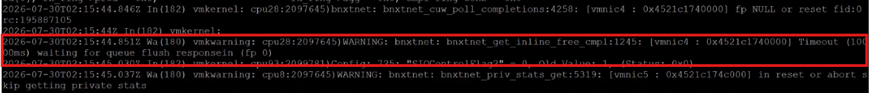

and also, messages such as "waiting for queue flush responsein"
