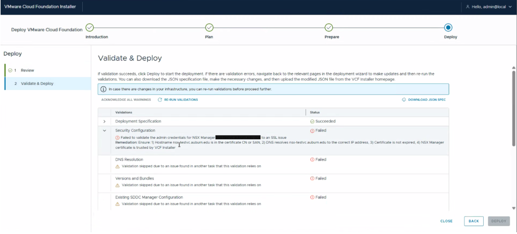

During VCF deployment or validation, the installation fails while validating the NSX Manager. You may observe the following symptoms:
  • The VCF Installer fails during the VMware NSX validation stage.
  • SSL certificate validation for the VMware NSX Manager fails.
  • REST API communication with the VMware NSX Manager cannot be established.
  • Errors indicate that the certificate is invalid or does not meet the required validation criteria.
