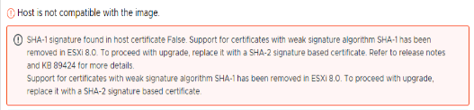

  • Multiple hosts show as 'Not Compatible' during vLCM compliance checks.
  • In addition with the incompatibility message, an error banner is shown, stating:
    SHA-1 signature found in host certificate False. Support for certificates with weak signature algorithm SHA-1 has been removed in ESXi 8.0. To proceed with upgrade, replace it with a SHA-2 signature based certificate. Refer to release notes and KB 8924 for more details.
  • Remediate tasks fail with the error: com.vmware.vcIntegrity.lifecycle.RemediateClusterTask.IncompatibleHosts.
