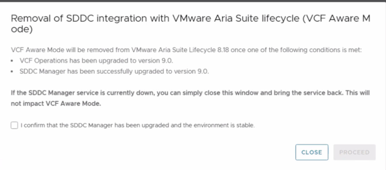

  • Every time Aria Suite Lifecycle Manager is refreshed, the following notification appears:
  • The notification persist even after connectivity between SDDC Manager and the Aria Suite Lifecycle Manager appliance is restored.

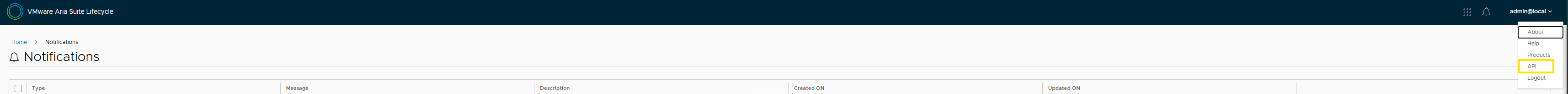

Option 1: Via the Aria Suite Lifecycle Manager User Interface
  1. Click the Notification icon in the top navigation bar.
  2. Select See all notifications.
  3. Locate the notification: "Removal of SDDC integration with VMware Aria Suite lifecycle (VCF Aware Mode)".
  4. Select the notification and click Clear Selected.

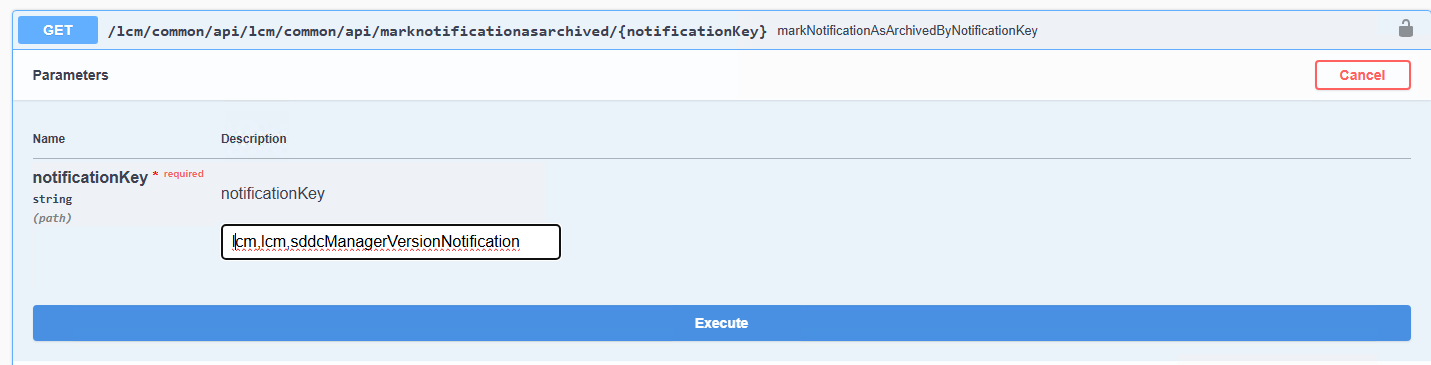

Option 2: Via API Call
  1. Authenticate to the Aria Suite Lifecycle API.
  2. Switch to definition to "2.private-internal-api"
  3. Under "Notification Controller", execute the following GET request to archive the notification:
    notificationKey: lcm,lcm,sddcManagerVersionNotification
