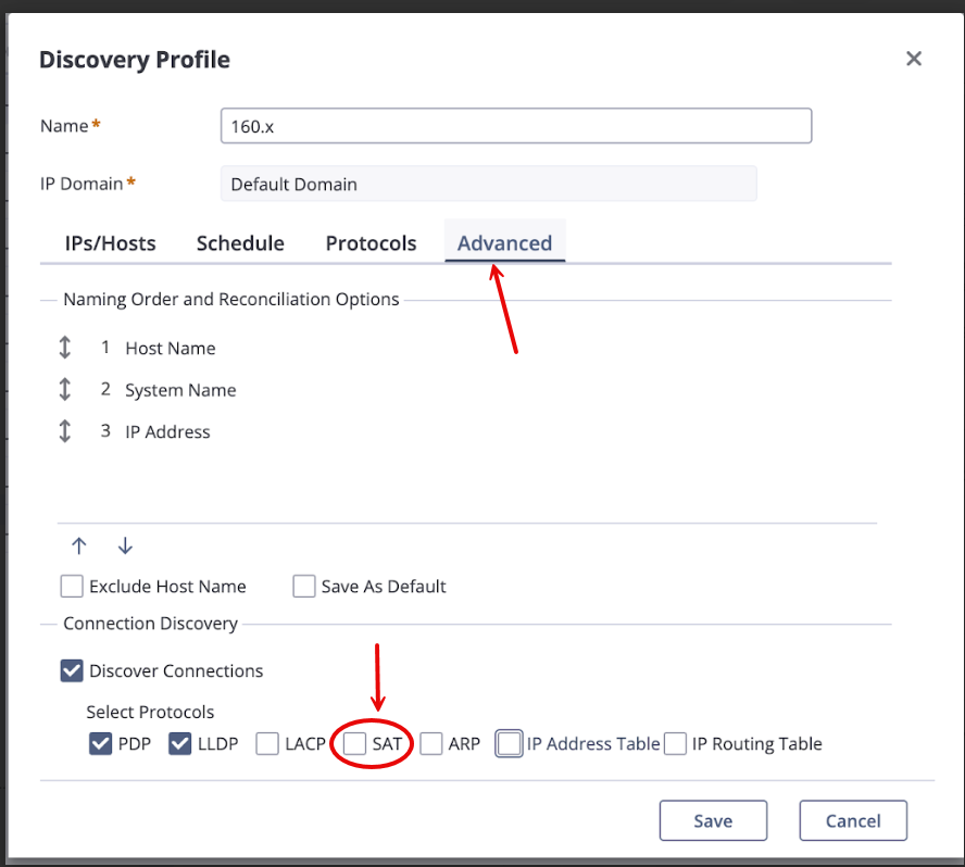

Topology utilizes Source Address Tables (SAT) as a mechanism for determining Layer 2 connectivity, particularly when other protocols like CDP or LLDP are unavailable.
Some of the current DB queries need to be optimized for better performance.
Disable the SAT protocol under advanced options in all Performance Management discovery profiles.
Defect DE209744 has been opened to fix this in a future build.
discover-connections
SAT is a protocol used during network discovery to resolve Layer 2 topology. It allows DX NetOps to map physical connections between devices by analyzing the learned neighbor MAC addresses stored in a switch's source address table.
  • Version Note: Enhanced SAT-based connection resolution was introduced in version 25.4.2.
  • Usage: It is typically used in conjunction with other discovery protocols such as CDP (Cisco Discovery Protocol), LLDP (Link Layer Discovery Protocol), and ARP (Address Resolution Protocol).
  • Functionality: When enabled in a discovery profile, the Data Aggregator uses SAT data to accurately map device connections, such as linking "pingable" nodes (like servers or printers) to specific switch ports.
