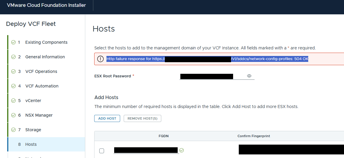

  • VCF 9.1 Installer shows following error message during the deployment, it takes long time to verify the hosts and shows the error message.
    Http failure response for https://<installer.example.com>/v1/sddcs/network-config-profiles: 504 OK
