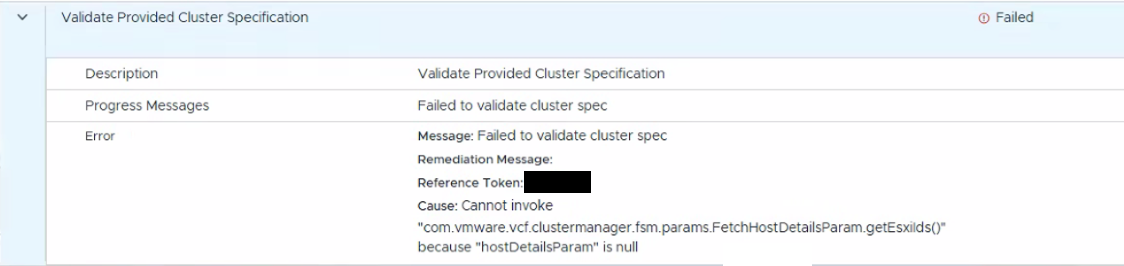

  • Adding new cluster to existing Workload domain fails with error
    Message: Failed to validate cluster spec
    Cause: Cannot invoke "com.vmware.vcf.clustermanager.fsm.params.FetchHostDetailsParam.getEsxilds()" because "hostDetailsParam" is null
