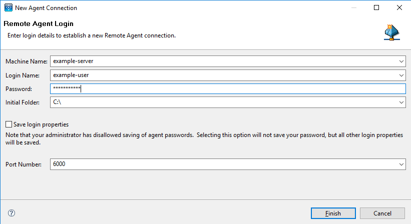

The user created a remote agent connection in Workbench

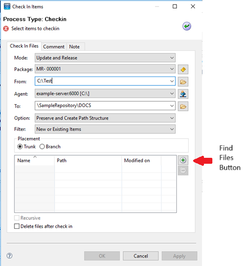

They then right clicked on a package and selected the Check In process, specifying the remote agent server in the "Agent" field instead of "local".  To gather the list of files to check in they clicked on the green "+" button next to the Name/Path/Modified On listbox.

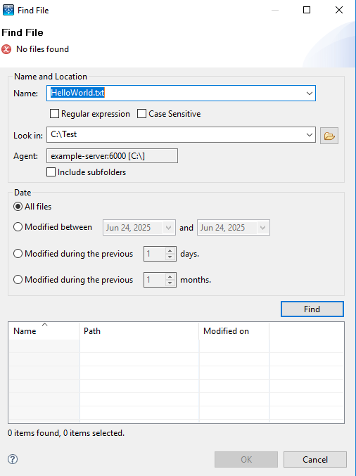

On the Find Files window, they provided the folder and file name to check in and clicked "Find", but Workbench searched for a long time and never "found" the file.

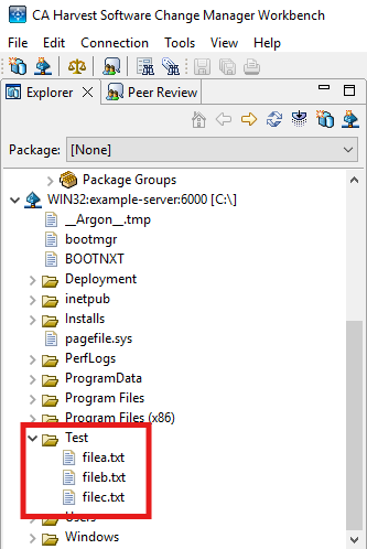

  • Go to the Agent connection in the Workbench Explorer pane and navigate to the folder to be sure the file exists.
