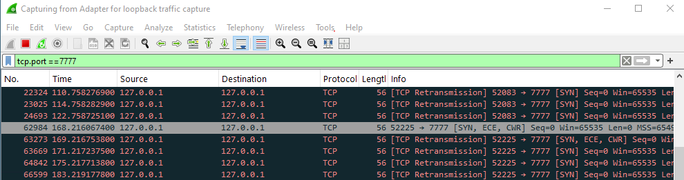

  • A packet capture on the loopback interface shows repeated TCP SYN retransmissions from 127.0.0.1 to 127.0.0.1:<stream_Port> with no SYN-ACK and no RST — the connection is never established, and no error is returned to the caller.

The built-in Windows SNMP Service snmp.exe is one of the services covered by this hardened profile, and its default profile permits UDP traffic only (matching classic SNMP's use of UDP 161/162). The Automic SNMP Subagent extends snmp.exe with its own custom TCP listener (default port 7777, configurable via stream_Port in ucsnmp1.ini) used to exchange MIB and trap data with the Automation Engine. This TCP listener falls outside the SNMP service's hardened network profile, so Windows silently drops every inbound connection attempt to it — without an RST, which is why the connection appears to simply hang rather than being actively refused.
