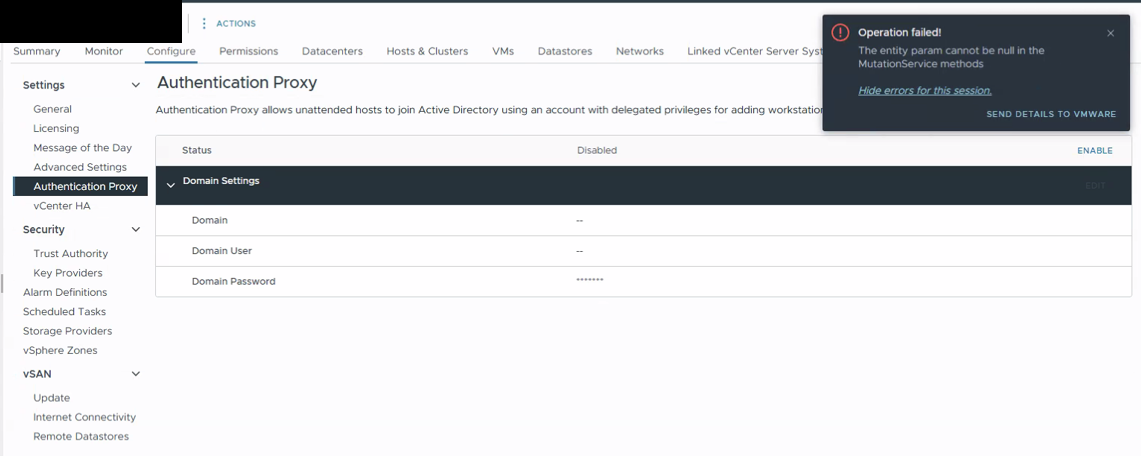

  • Authentication proxy is enabled when logging into vCenter UI as <[email protected]>
  • When logging into vCenter UI as AD user assigned with administrator privilege, Authentication Proxy shows as disabled. When attempting to enable fails with error "The entity param cannot be null in the MutationService methods" as below,
  • Authentication Proxy functionality wise working fine.

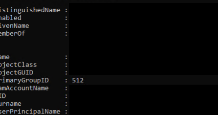

  • On AD server open PowerShell and run below command for affected user. Output shows with "PrimaryGroupID: ###" while expected ID is 513 which is Default Domain Users
    Get-ADUser <username>-Properties primaryGroupID, memberOf
    • Example of wrong Primary Group set with 512 instead of 513:
vCenter 8.x
It is caused by Active Directory configuration issue specific to the AD user account, where his primary group was set to some group (like, 'Domain Admins') instead of the standard 'Domain Users'. That single AD attribute is what caused vCenter to inconsistently see AD user account.
