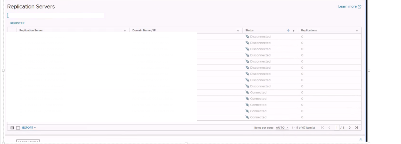

  • In the SRM interface, ESXi hosts are listed as disconnected under Replication Servers
