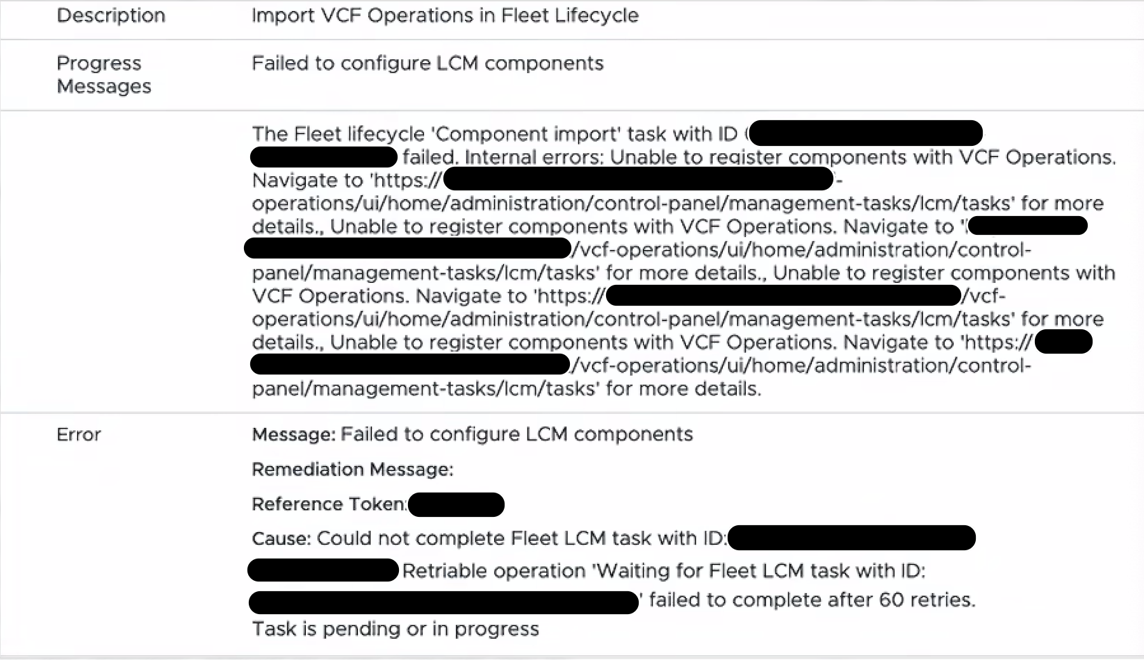

Message: The Fleet lifecycle 'Component import' task with ID <ID> failed. Internal errors: Unable to register components with VCF Operations.

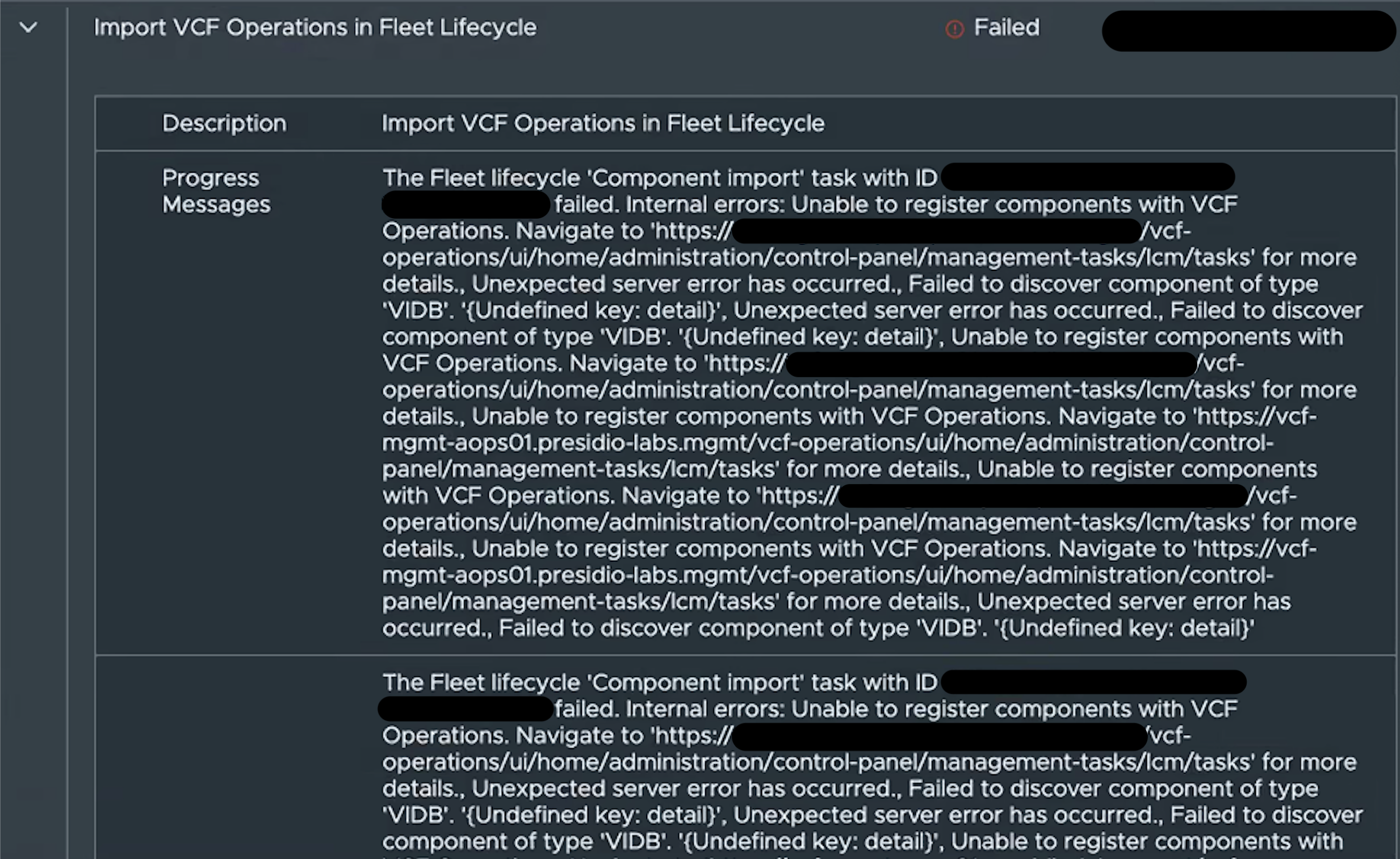

Failed to discover component of type 'VIDB'. "(Undefined key: detail)', Unexpected server error has occurred., Failed to discover component of type 'VIDB'. '(Undefined key: detail), Unable to register components with VCF Operations.
