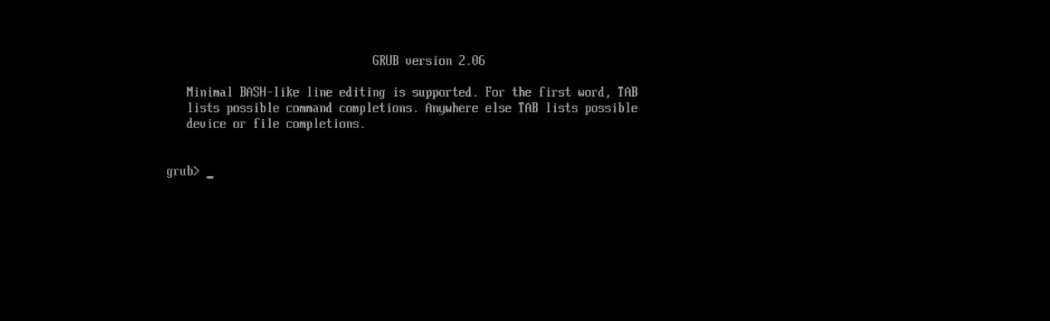

After migrating a Red Hat Enterprise Linux 9 (RHEL 9) server from a physical machine to a VMware virtual machine (P2V), the virtual machine fails to boot into the OS normally. It repeatedly falls back to either Emergency Mode or the grub> prompt console.
VMware vSphere ESXi 8.x
Cause 1: /etc/fstab Disk UUID Mismatch During the P2V process, the UUIDs of the new virtual disk partitions (/dev/sda#, /dev/sda##) changed. Consequently, the OS failed to locate and mount the physical machine's original /boot and /boot/efi mount points during startup, triggering a mount lockup and forcing the system into Emergency Mode or the grub> prompt.
Cause 2: Missing UEFI NVRAM Boot Entries & Path Incompatibility The target virtual machine lacks the original NVRAM boot entries from the source physical machine. Additionally, there is a path compatibility gap between RHEL 9's default UEFI boot structure and ESXi's fallback boot mechanism, causing GRUB to fail to locate its configuration file upon reboot.

Step 1: Manually Boot into the Operating System
At the grub> prompt, execute the following commands in sequence (use the Tab key for auto-completion if needed):
set root=(lvm/rhel-root)
linux (hd0,gpt2)/vmlinuz-5.14.0-503.11.1.el9_5.x86_64 root=/dev/mapper/rhel-root ro
initrd (hd0,gpt2)/initramfs-5.14.0-503.11.1.el9_5.x86_64.img
boot
