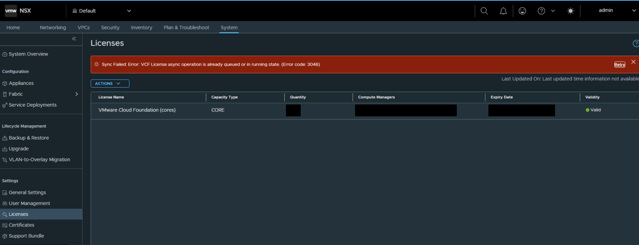

When navigating to the Licenses menu in the NSX UI, the following error message is displayed:
'Sync Failed: Error: VCF License async operation is already queued or in running state. (Error code: 3046)
