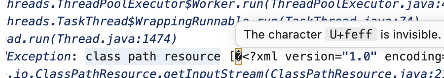

org.springframework.security.saml2.Saml2Exception: Unable to build SAML relying party registration for: <idp-alias>
Caused by: java.io.FileNotFoundException: class path resource [<?xml version="1.0" encoding="utf-8"?><EntityDescriptor ...>] cannot be opened because it does not exist

This is caused by a recent UAA change to honor the skipSslValidation setting when fetching SAML IdP metadata during login (introduced in UAA 2.15.0 / core v79.3.2). Microsoft Entra ID's federation metadata endpoint returns its response with a leading UTF-8 byte-order-mark (U+FEFF). This is normal behavior on Entra's side.
As part of the change above, UAA's logic for classifying fetched/stored metadata (as inline XML data vs. a resource location) no longer correctly accounts for this leading BOM character. Because the BOM sits in front of the XML declaration, UAA fails to recognize the response as valid metadata content and instead attempts to resolve the entire metadata document as if it were a file/classpath location, resulting in the FileNotFoundException above.
