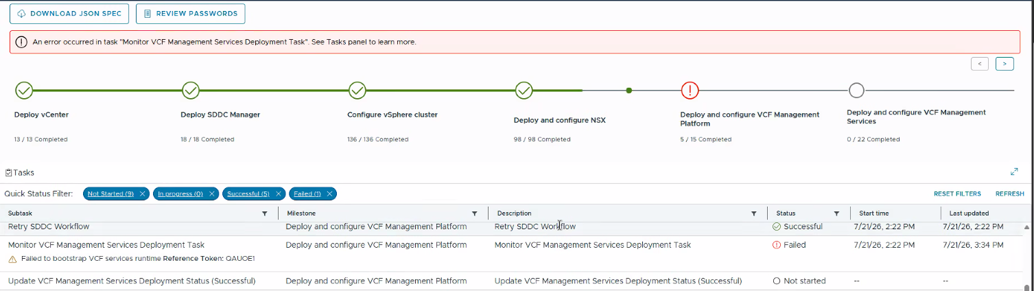

When deploying VMware Cloud Foundation (VCF) 9.1, the deployment task fails during the "Deploy and configure VCF Management Platform" step with the subtask "Monitor VCF Management Services Deployment Task" and error "Failed to bootstrap VCF services runtime":

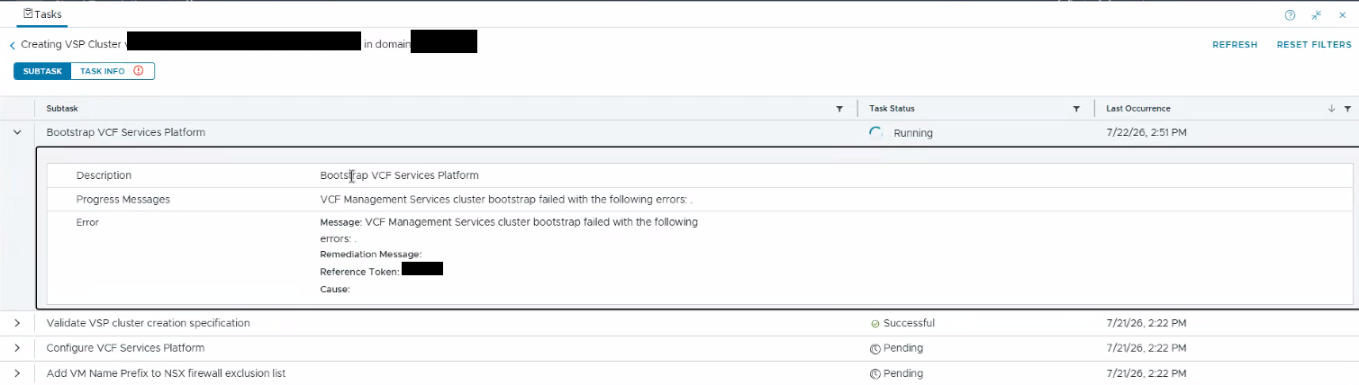

Reviewing the domainmanager.log on the SDDC Manager appliance reveals the following error:
LocalProcess ERROR: 2026-07-22 13:45:08 - 2026/07/22 13:45:08 Starting SSH log tailing with retry mechanism (max 10 attempts)
LocalProcess ERROR: 2026-07-22 13:45:08 - 2026/07/22 13:45:08 Starting SSH attempt 1 (showing all logs from beginning)
LocalProcess ERROR: 2026-07-22 13:45:08 - 2026/07/22 13:45:08 Executing SSH command for bootstrap log tailing...
LocalProcess ERROR: 2026-07-22 13:49:48 - 2026/07/22 13:49:48 SSH log tailing completed successfully
LocalProcess ERROR: 2026-07-22 13:49:48 - 2026/07/22 13:49:48 waiting on the install task to complete...
LocalProcess ERROR: 2026-07-22 13:49:48 - 2026/07/22 13:49:48 install API Task with Id ligjkhptpjbexbowm7hneuqn2y has status Running
LocalProcess ERROR: 2026-07-22 13:50:18 - 2026/07/22 13:50:18 install API Task with Id ligjkhptpjbexbowm7hneuqn2y has status Running
LocalProcess ERROR: 2026-07-22 13:50:48 - 2026/07/22 13:50:48 install API Task with Id ligjkhptpjbexbowm7hneuqn2y has status Running
LocalProcess ERROR: 2026-07-22 13:51:18 - 2026/07/22 13:51:18 install API Task with Id ligjkhptpjbexbowm7hneuqn2y has status Failed
LocalProcess ERROR: 2026-07-22 13:51:18 - Error: install failed: Failed
LocalProcess ERROR: 2026-07-22 13:51:18 - 2026/07/22 13:51:18 error: install failed: Failed
2026-07-22T13:51:30.650+0000 ERROR [vcf_dm,6a60c7c77fac34afae6a5cd68a7effef,872d] [c.v.e.s.o.model.error.ErrorFactory,dm-exec-16]  [ABCDEF] PUBLIC_VSP_CLUSTER_BOOTSTRAP_FAILED_DETAILED VCF Management Services cluster bootstrap failed with the following errors: .
