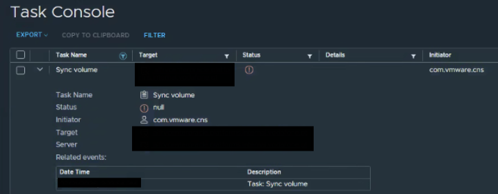

After upgrading to vCenter 8.x, you see frequent tasks related to Cloud Native Storage (CNS) fail with the error: Sync Volume error

After upgrading to vCenter 8.x, CNS runs a full sync on datastores to clean up
To resolve the issue:
  • If you use both file and block volume in your environment, refer KB 399208
  • If there is no record found for volume_id start with the pattern ""file:" then please refer below to resolve:
    • In the VPXD log, you will see entries similar to below:
    • ->    msg = "Received SOAP response fault from [<<io_obj p:0x00007f900c7259a8, h:74, <UNIX ''>, <UNIX '/var/run/envoy-hgw/hgw-pipe'>>, /hgw/host-####/vpxa>]: retrieveVStorageObjectMetadata
    • Refer the link in the logs and we see a "host-####" which may be having some stale lock file.
    • To address this, make a note of  "host-XXX" ; then go back to Vcenter UI and select each host and refer URL section that matches with the host reported in the logs.
    • Perform the management service restart to remove stale lock file. Restarting Management Agents in ESXi
