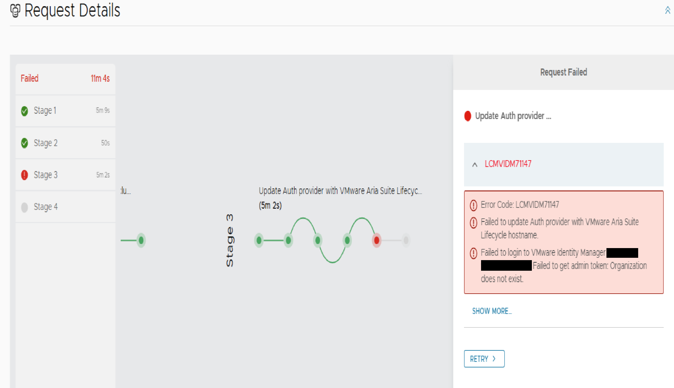

  • Applying vIDM 3.3.7 CSP Patch fails during the step 'Patch Postgres Cluster' with the following errors:
Error code: LCMVIDM71147
Failed to update Auth provider with VMware Aria Suite Lifecycle hostname
Failed to login to VMware Identity Manager vIDM_FQDN. Failed to get admin token: Organization does not exist
