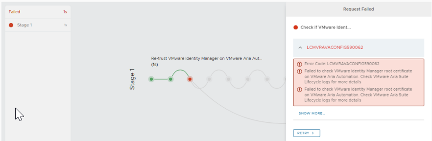

  • Re-Trust with VMware Identity Manager task against VMware Aria Automation, the request fails with the following error :
    Error Code: LCMVRAVACONFIG590062
    Failed to check VMware Identity Manager root certificate on VMware Aria Automation. Check VMware Aria Suite Lifecycle logs for more details

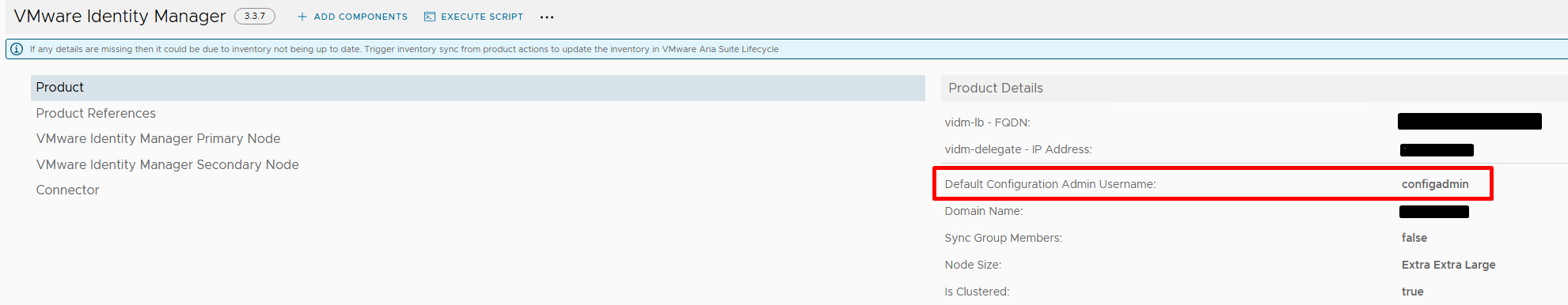

  • Validate the Default Configurator Admin Username, in the global environment on VMware Aria Suite Lifecycle 8.x.

    • Replace ID2 with the user found in step 1.
