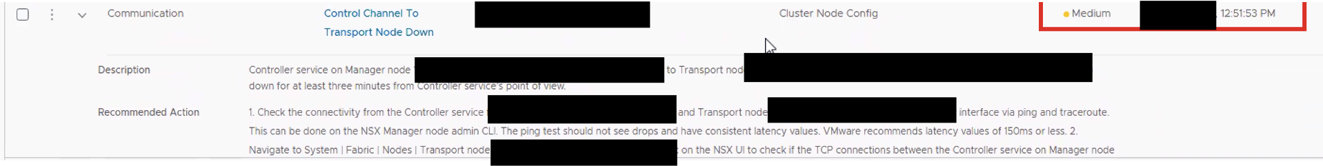

Intermittent transport node connectivity alarms occur across the ESXi cluster.
The NSX Manager UI intermittently reports the alarm: "Control channel to transport node down" for ESXi Transport Nodes.
The alarm typically clears automatically after a few minutes without manual intervention.
