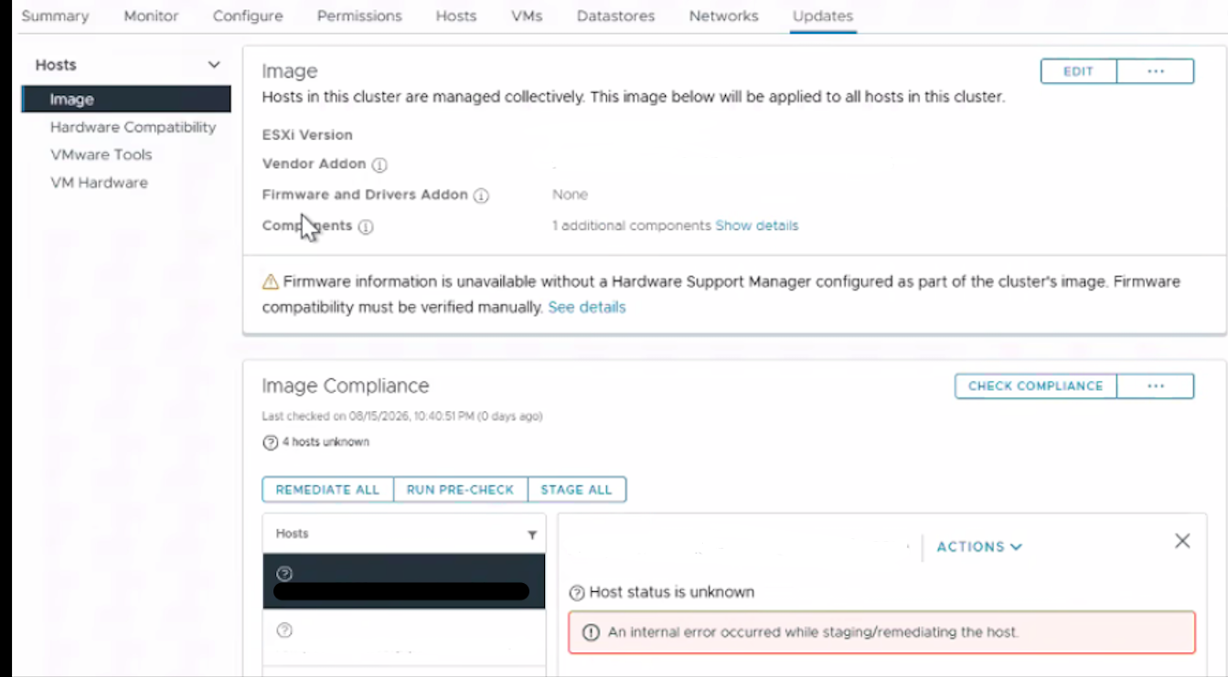

Host status is unknown and An internal error occurred while staging/remediating host."SHA-1 signature found in host certificate False. Support for certificates with weak signature algorithm SHA-1 has been removed in ESXi 8.0. To proceed with upgrade, replace it with a SHA-2 signature based certificate."/var/run/log/lifecycle.log file on the ESXi host contains the following errors:YYYY-MM-DDTHH:MM:SS Wa(12) lifecycle[####]: BootBankInstaller:249 Ignoring error when loading bootbank: Error in loading database for bootbank /altbootbank: ('/altbootbank/imgdb.tgz', 'Error parsing VIB/ImageProfile from DB /altbootbank/imgdb.tgz: MemoryError - ')YYYY-MM-DDTHH:MM:SSZ Er(11) lifecycle[8965070]: QuickPatchInstaller:1457 Unexpected error occurred while attempting to run Quick Patch scan scripts: Current ESXi version does not provide a mechanism to mount a tardisk into a ramdisk.YYYY-MM-DDTHH:MM:SSZ Er(11)[+] lifecycle[8965070]: Traceback (most recent call last):YYYY-MM-DDTHH:MM:SSZ Er(11)[+] lifecycle[8965070]: File "/lib64/python3.11/site-packages/vmware/esximage/Installer/QuickPatchInstaller.py", line 1436, in _runScanScriptsYYYY-MM-DDTHH:MM:SSZ Er(11)[+] lifecycle[8965070]: Ramdisk.MountTardiskInRamdisk(downloadPath,YYYY-MM-DDTHH:MM:SSZ Er(11)[+] lifecycle[8965070]: File "/lib64/python3.11/site-packages/vmware/esximage/Utils/Ramdisk.py", line 229, in MountTardiskInRamdiskYYYY-MM-DDTHH:MM:SSZ Er(11)[+] lifecycle[8965070]: raise Errors.InstallationError(None, None, msg)YYYY-MM-DDTHH:MM:SSZ Er(11)[+] lifecycle[8965070]: vmware.esximage.Errors.InstallationError:Current ESXi version does not provide a mechanism to mount a tardisk into a ramdisk./var/run/log/vmkernel.log file on the ESXi host displays the following admission failure errors:YYYY-MM-DDThh.mm.ss In(###) vmkernel: cpu#.####)Admission failure in path: host/vim/vmvisor/settingsd-task-forks/python.####:sh.####:worldGroup.####
OR
YYYY-MM-DDTHH:MM:SSZ In(182) vmkernel: ... requires <X> KB, asked <X> KB from python.<PID> which has <Y> KB occupied and <Z> KB available.The ESXi host encounters memory exhaustion within the host/vim/vmvisor/settingsd-task-forks resource group. The default memory limit is insufficient for the vLCM daemon to parse the metadata zip files provided by the vCenter Server during the upgrade/remediation process.

Perform any of the below methods to work around this issue:
domain-c9" in the sample screenshot below):depot-override.sh" script attached to this KB.vi' editor.[ ~ ]# vi depot-override.sh[ ~ ]# chmod +x depot-override.sh ./depot-override.sh configure --clusters <Cluster MoID>Vendor addon <AddonName> with version <ESX version > cannot be found in depot.
Component <component name> cannot be found in depot.Enter SSO Administrator credentials and vCenter Server FQDN when prompted by the script.[ ~ ]# ./depot-override.sh configure --clusters domain-c9vCenter username [[email protected]]: [email protected]vCenter password:Logging to /tmp/depot-override-######-######.logvCenter FQDN [vcenter.example.com]: vcenter.example.com

Open an SSH session to the affected ESXi host as the root user.
Check the current memory configuration for the settingsd-task-forks group on the affected ESXi host by executing the following command:python -c "from configRP import ResourcePool; rp = ResourcePool('host/vim/vmvisor/settingsd-task-forks'); print(rp.getCurrentMaxMemSize())"
Execute the following command to increase the resource pool size such that the total now is 500MB. For eg: If Step 2 returns 345MB, the increase should be 155MB. If it gives 315MB, the increase should be 185MB etc.:python -c "from configRP import ResourcePool; rp = ResourcePool('host/vim/vmvisor/settingsd-task-forks'); rp.increaseResourcePoolSize(0, 155)"Note: This command applies a temporary configuration that does not persist across a reboot. This is the intended behavior, as the value should revert to its original state when the host reboots during patching.
Re-run the validation command to verify the updated memory limit applies successfully.python -c "from configRP import ResourcePool; rp = ResourcePool('host/vim/vmvisor/settingsd-task-forks'); print(rp.getCurrentMaxMemSize())"
In the vCenter Server inventory, select the affected ESXi host, navigate to Updates, and click Check Compliance to refresh the host status.
Verify that the Actions menu is now fully accessible.
Re-initiate the patching operation.
