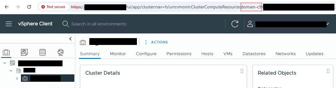

  1. Login to vSphere Client and select the vSphere Cluster.
  2. Note down the MoID of the Cluster, for eg. "domain-c9" in below sample screenshot:
